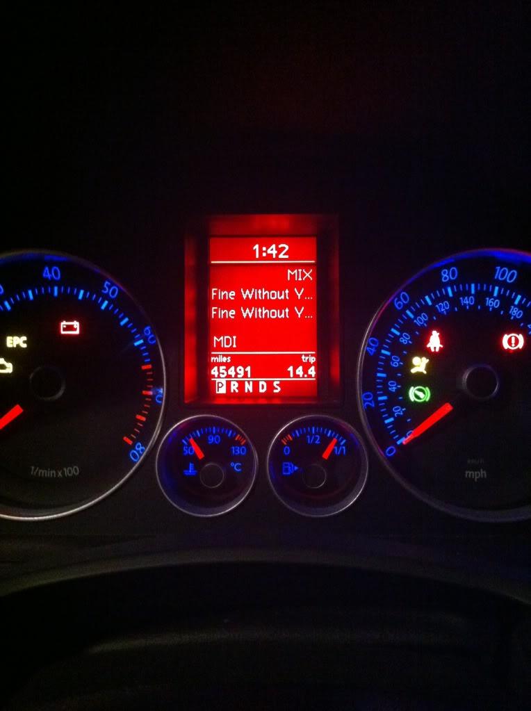

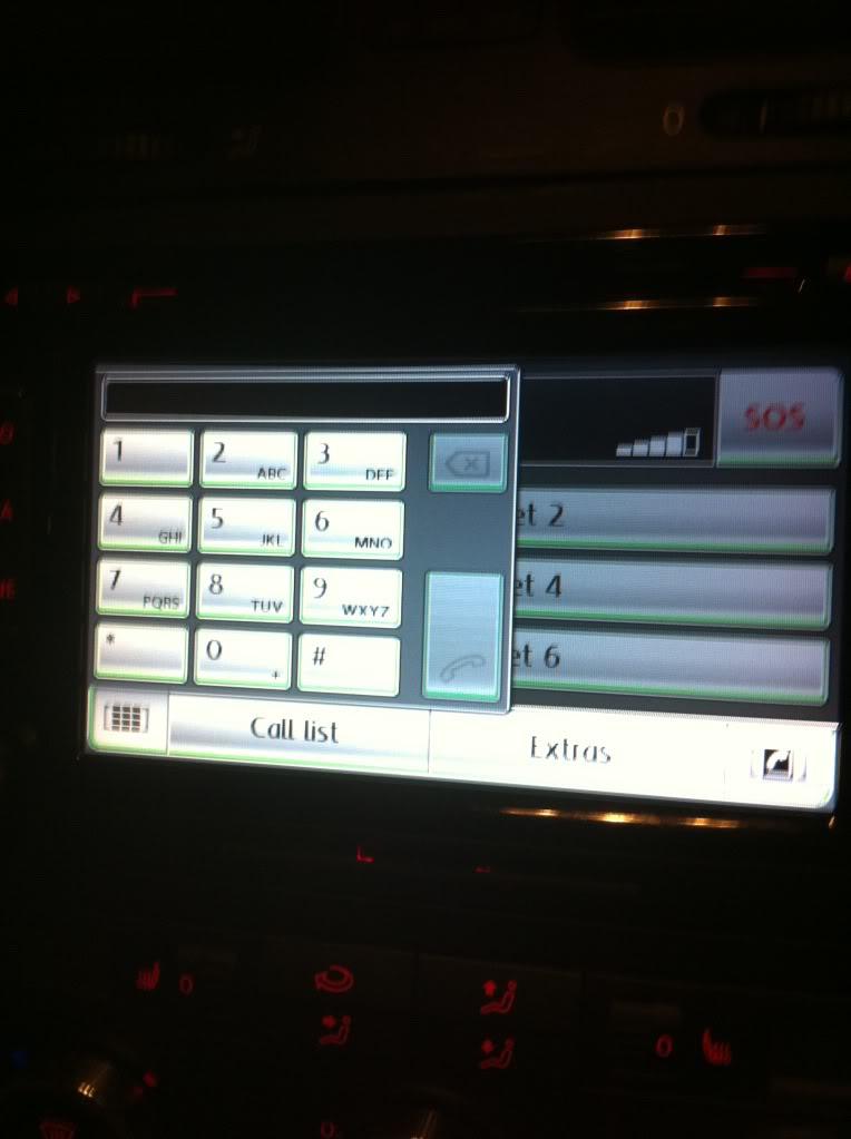

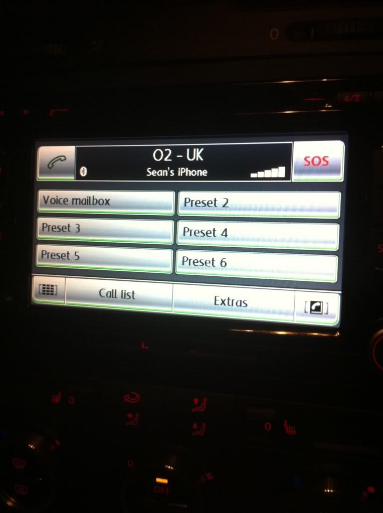

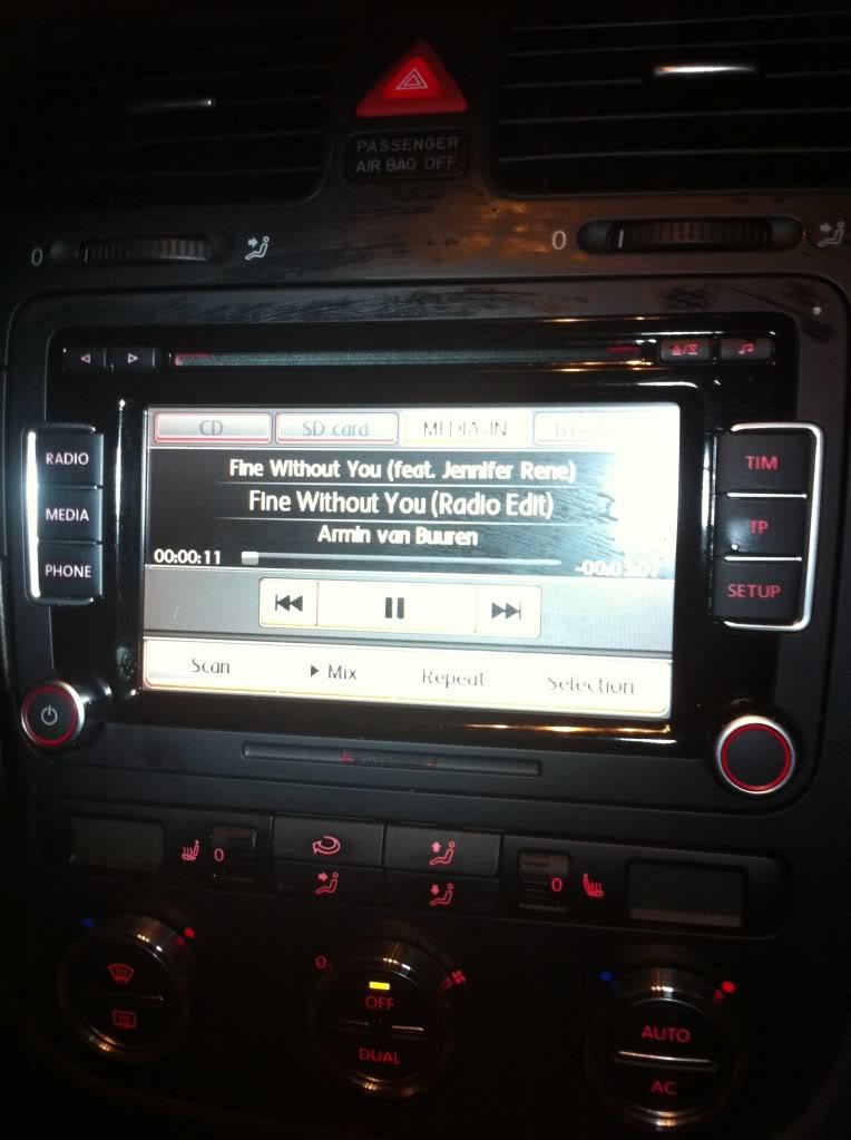

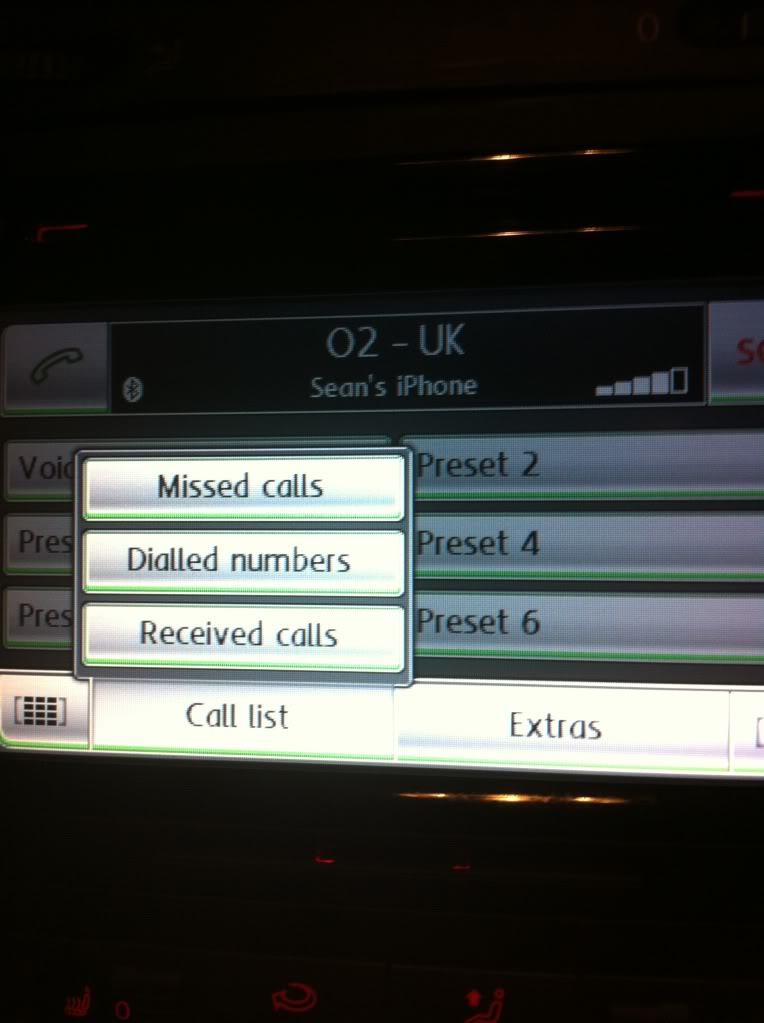

Hey folks, right, all is in, and working, I finished this not long ago so it was dark when I took the pictures but hopefully shows what's needed.
Very easy to use, I have setup the iPod connector and bluetoothed the iPhone4, phonebook, full call control is possible from the radio itself, also from the highline dash / MFSW controls.
Here are some of the screens;
(iPod shows track details etc etc which is good, it also shows them on the highline dash but thats a bit pointless as the names are often too long!)
Ignore the wet marks on the last picture, I used cleaning wipes to clean the dash as I had made it look a bit untidy prior to that!
