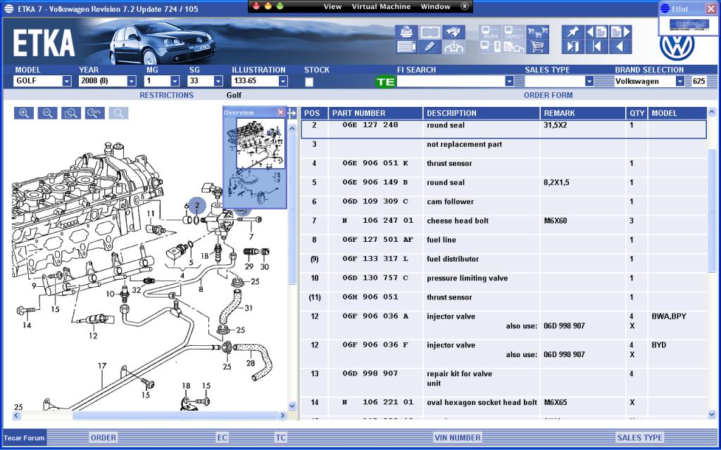

Has no one replaced the highlighted seal when replacing the follower?
If you have to ask why, you'll never understand.
Re: Now this is a fooked cam follower check yours asap
« Reply #28 on: February 12, 2011, 07:58:31 pm »
i got that seal when i got my follower  :smiley:
