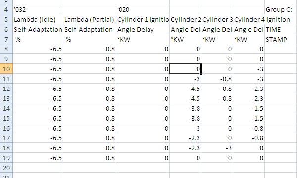

Well after £108 on a new MAF sensor,
      Lambda (Idle)   Lambda (Partial)
   TIME   Self-Adaptation   Self-Adaptation
Marker   STAMP    %    %
   0.04   0   0
   0.18   0   0
   0.3   0   0
   174.52   -2.7   -0.4
   174.63   -2.7   -0.4
Hope fully fingers crossed the fault doesnt return :jumpmove: At least the values are better than before

Oh well, the joy was short lived........
Has anyone any other idea what it could be?
Does anyone know if theres any reason why it would be running so rich on idle, yet ok readings whilst driving about? If it was the lambda sensor, would the readings whilst at revs also be higher, and if it was a vacuum leak, these readings would also change, but the continue to remain constant whilst at high rpms?
A bit daunting considering MOT due very soon, bet it fails on emissions :sad1:
Is anyone after a maf :signLOL:

You know that there's 2 lambda sensors right? try and swap the old with the new and put the new instead of the second one?? just a thought  :smiley:

I wasnt sure if they were the same part number. By the looks of it I might need to up the fuel ratio, as it looks like the timing is too rich when the timing is pulling.

Why did you change the lambda sensor?

I didnt. I was trying to rule things out that could be causing the fault. Only fuel pump, lambda sensor and maybe the pcv left from what I can gather that can be at fault?
