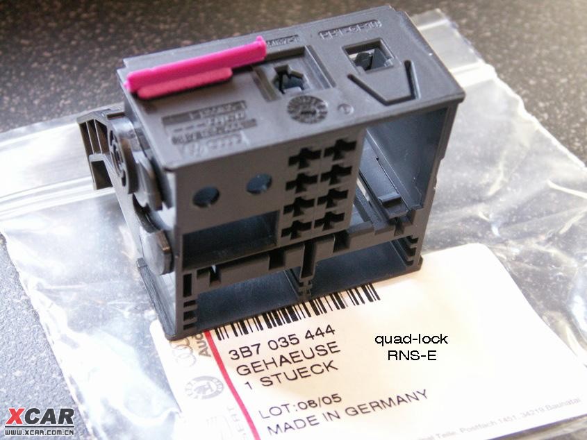

Does this have a part number ?, its the connector for the back of the RNS510 etc ? :happy2:

Are you referring the the quadlock holder all the units snap into?

You got Etka?  Go into Rocco MY 10 and search on RNS.  Go to page 0-35 illustraion 00-35.  Item 5 is the RNS 510.
Then click on it and click on the Right icon in the addl info and look at the repair parts.
I think it is the 26 pin connector with cap?  7L6 972 726?

Lookin on EL dave that doesnt look right. Thats a 26 Pin connector
Here is the part code :)
3B7 035 444

Probably right alex,  it doesn't list any others.

defo that one, as pictured :)

There seems to be a few versions on Etka dependent on year.  Same part number with suffix A is 31-05-10 onwards.
