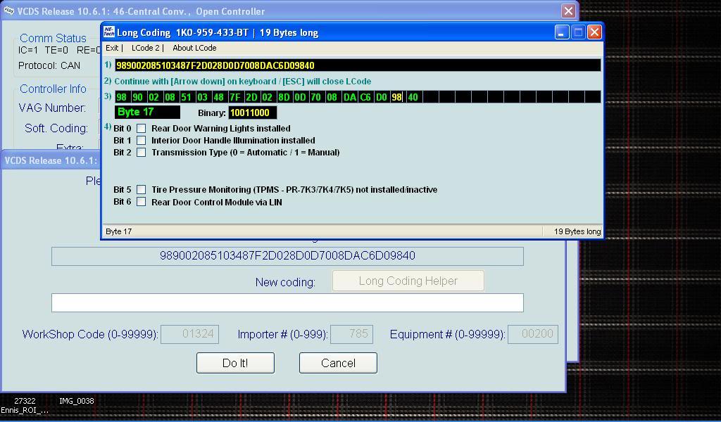

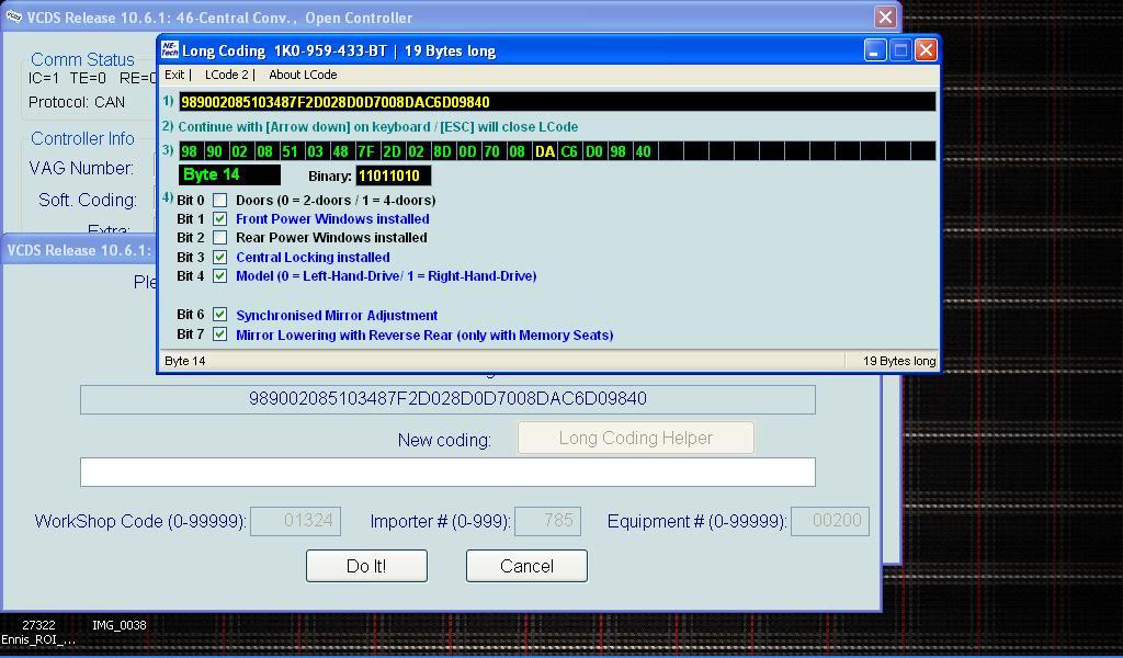

But i still think it will work in your car. Etka lists it for both 2 and 4 door cars and there are options in the coding for 4 doors:

You would have the modules swapped and the glovebox back in in 20 minutes. Dont overtighten the plastic nuts holding the ccm carrier. And take screen shots of your existing coding before you swap.
