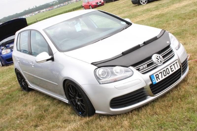

My Black TD PR1.2 were 18x8.0 et45 with running 225/40 michelins on my old r32, and i ran 5mm spacers on back... same as running 11mm spacers on standard wheels... plenty of room inside, had no rubbing on back... fronts rubbed when turning in extreme, as they had peeled paint off lip of arch, but car was lowered dramatically on coilovers...

et45 is fine with 18"x8.0" with 225x40 r18's wouldn;t go lower than ET42...
These are ET45 18"x8 but with 5mm spacer on back...
Diesel Daily Hack.
