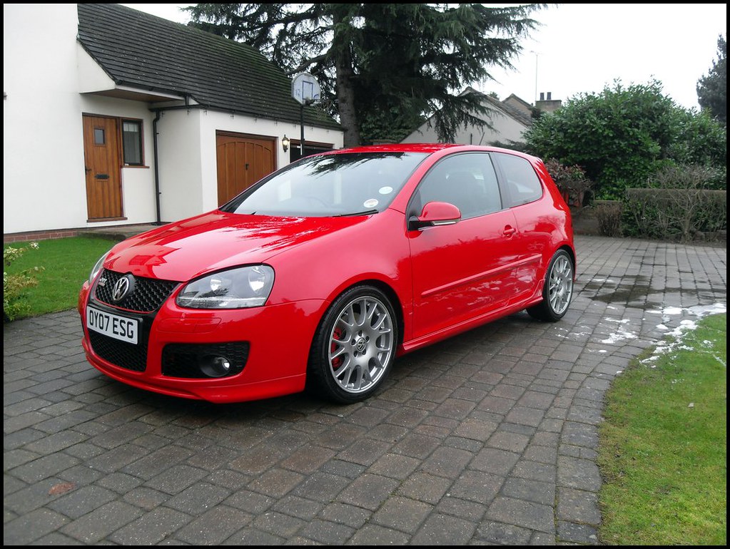

Sportlines:

Sportlines do look mint Keano, as your car shows.
Do you like the handling too?

« Reply #22 on: April 07, 2011, 07:06:28 pm »
Thankyou  :happy2:
Yes. Handling is much better. Alot more confidence inspiring!
