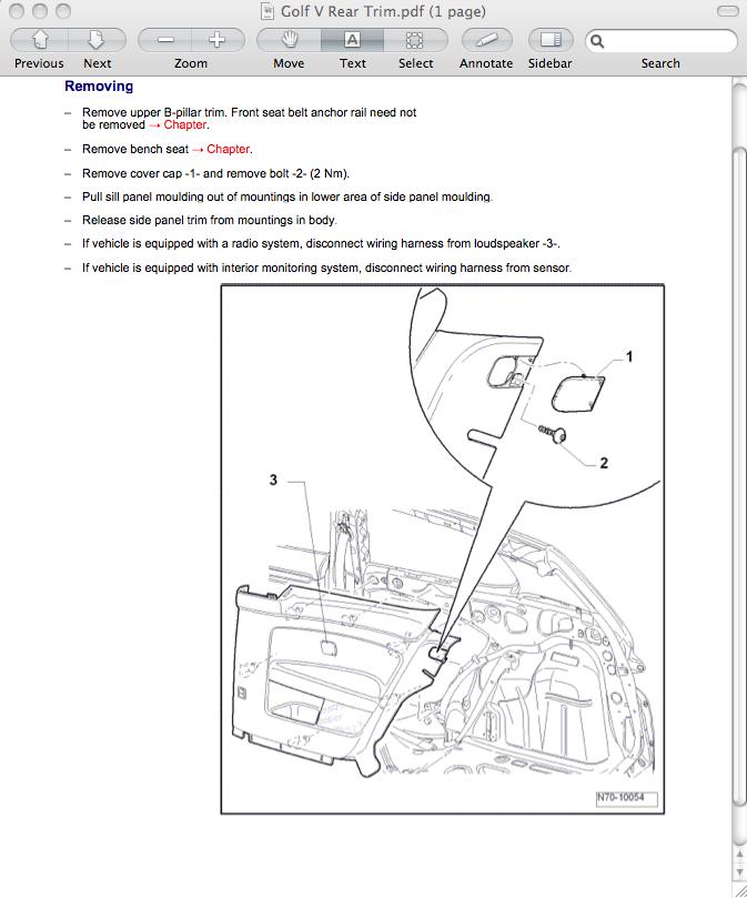

Thank you, could somebody who has Elsa have a look for me to see if there is a guide on removing the rear trim when the rear bench is removed  :happy2:

That help?

« Reply #11 on: April 19, 2011, 09:38:24 am »
Superb, Thank you very much  :happy2:

I couldn't make it any clearer from ELSA so just saved as a PDF.
If you can't read that properly PM me your email and i'll email you the PDF :happy2:
