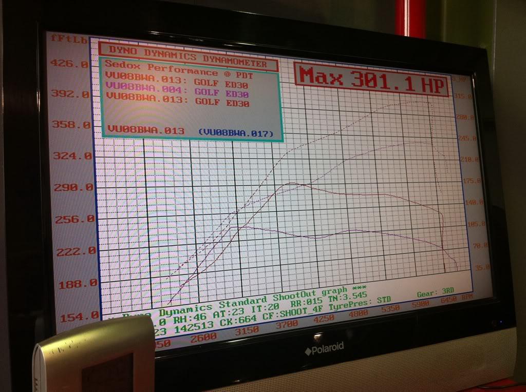

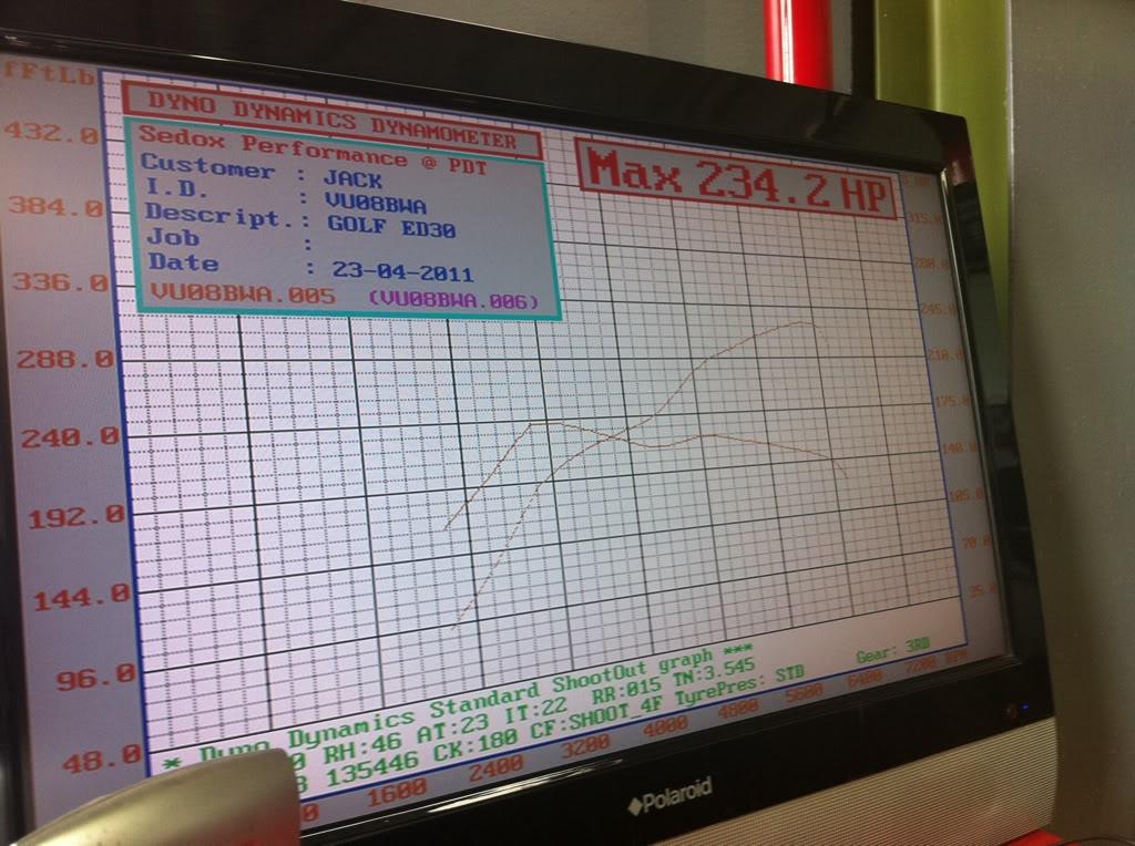

Well fitting is easy, save sets it up on the dyno and does a run showing standard power
This is my standard power with a forge twintake fitted on the same day

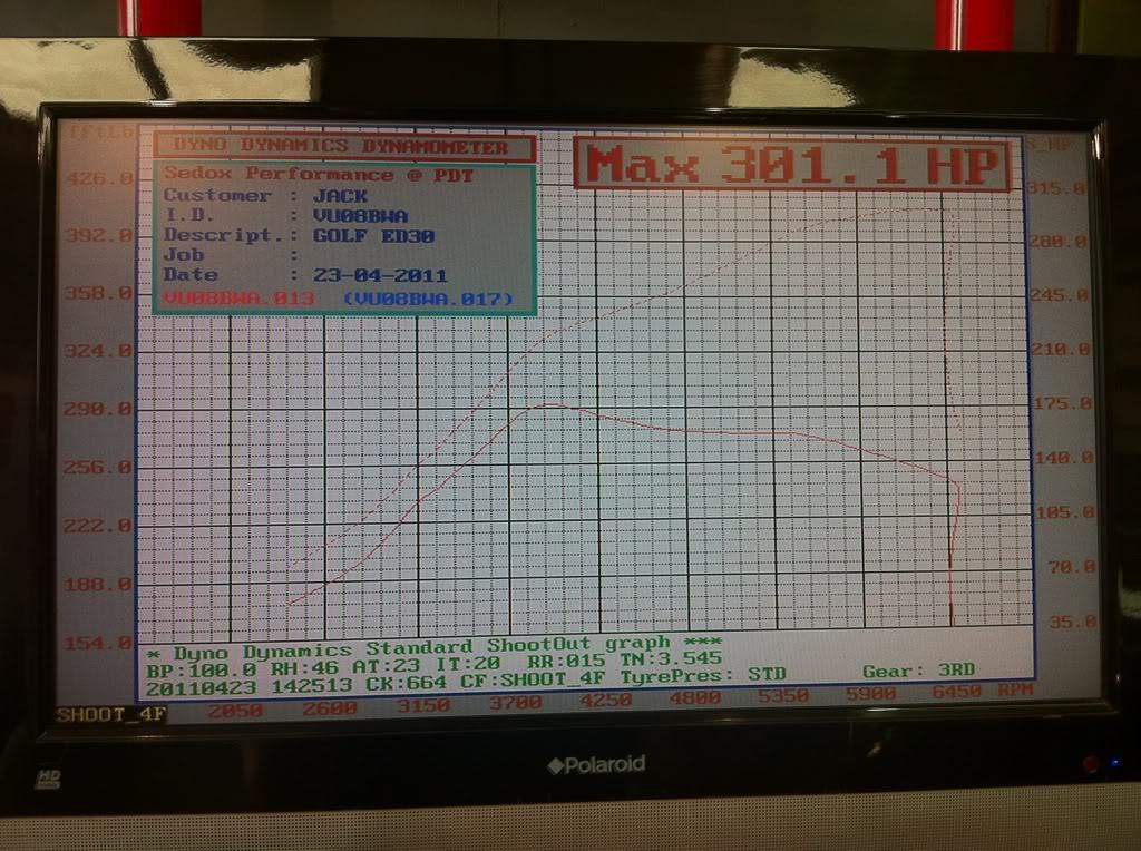

Once your dyno run is complete he then uploads the file and does a few more dyno runs whilst making adjustments to achieve full engine potential up untill you get the graph that dave is happy with and looks safe
Here is my final figure

but i still don't get why PDT keep on using funny/strange scaling on their graphs  :stupid: it's really confusing.
Most places i've been to use simple straight forward blocks of 50 for both BHP and Lb/Ft and 500 for RPM.
Here's an example.

what going on with your torque curve??  :confused:
420lb ft of torque??
That's about 100lb ft too much?
Arh, I spot his graph scales are reverse then other dyne dynamics print outs.
« Last Edit: April 24, 2011, 12:36:47 pm by Saint Steve »

Red one on my graph is a Revo S1 Roc R.
Ok both make same power up top but torque curve is where it counts. Some would say PDT's map would be easier on a manual gearbox/clutch i suppose as it doesn't do the torque that Revo does.
PDT max torque of ~ 290 lb/ft is reached at almost 4k rpm per that graph but drops to ~270 lb/ft immediately.
Revo hits 300 lb/ft at around 3.6k rpm holds it till almost 5k rpm.  :smiley:

hence my post steve re confusing graphs...as you're reading it wrong. lower plot is for torque (using left hand scale) and upper plot is for BHP (using right hand scale)
see how it confuses people! Why can't it be like SRR both scales the same so easy to see the power/torque curves and figures at different rev points

I've got 3 different pictures for this torque and bhp, both have diffrent lines on them, I dont understand how to read them, dave kept changing something to make the lines change but this was just a photo I took, the torque will drop slightly (no hpfp) but it's all spot on, I'll pm dave and see if he has a picture of the proper graph
www.distinctdetailing.co.uk
Offline Janner_Sy
  • -Receive: 113
  • Posts: 5392
Re: PD tuning stage 1 map
« Reply #10 on: April 24, 2011, 01:16:30 pm »
post them all up, we'll tell you the difference and how to read them  :happy2:
Offline chungster
  • Posts: 1963
« Reply #11 on: April 24, 2011, 01:17:50 pm »
i noticed that on the 2 pics you posted..the scaling changed between stock run and remapped run. Why do this???  Very strange........

What is Sedox performance?, just noticed it on the top of the dyno graph.  http://www.sedox-performance.com/index.php?option=com_content&view=article&id=3&Itemid=14&lang=en  Site showsPDT is the sole UK distributer of their software? So is this a PDT map or a Sedox performance map?

I just went photo crazy and took all the pictures I could  :rolleye:
irrelavent of final figures that graph shows the actual gains are good, which is what matters
