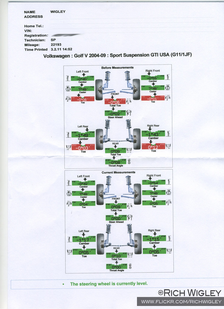

This is my current setup:
I would only change the toe out into toe in 0.05' (after the bruce explained why I need this).
You may see the discussion on my ride topic (http://www.mk5golfgti.co.uk/forum/index.php/topic,24398.60.html)

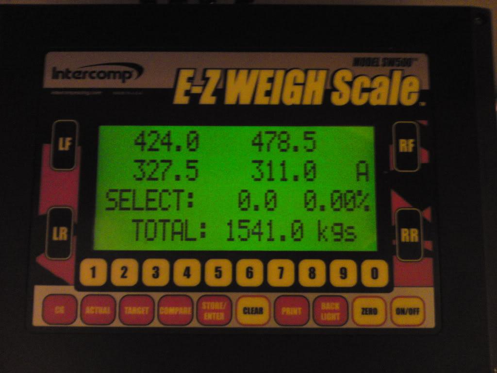

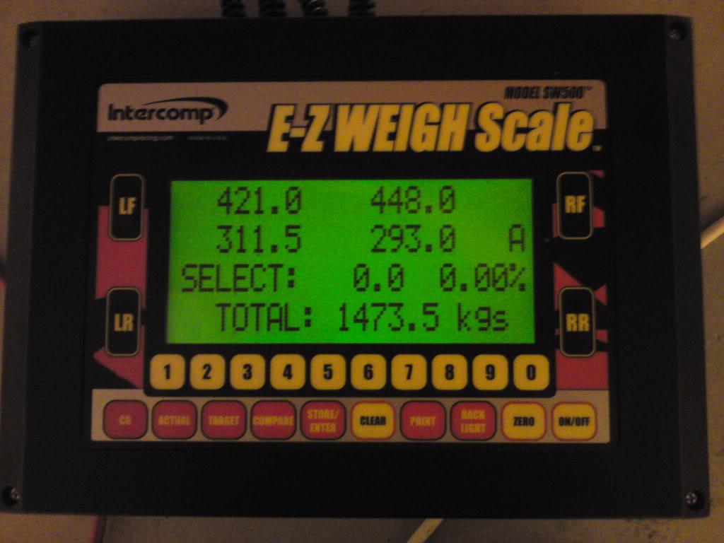

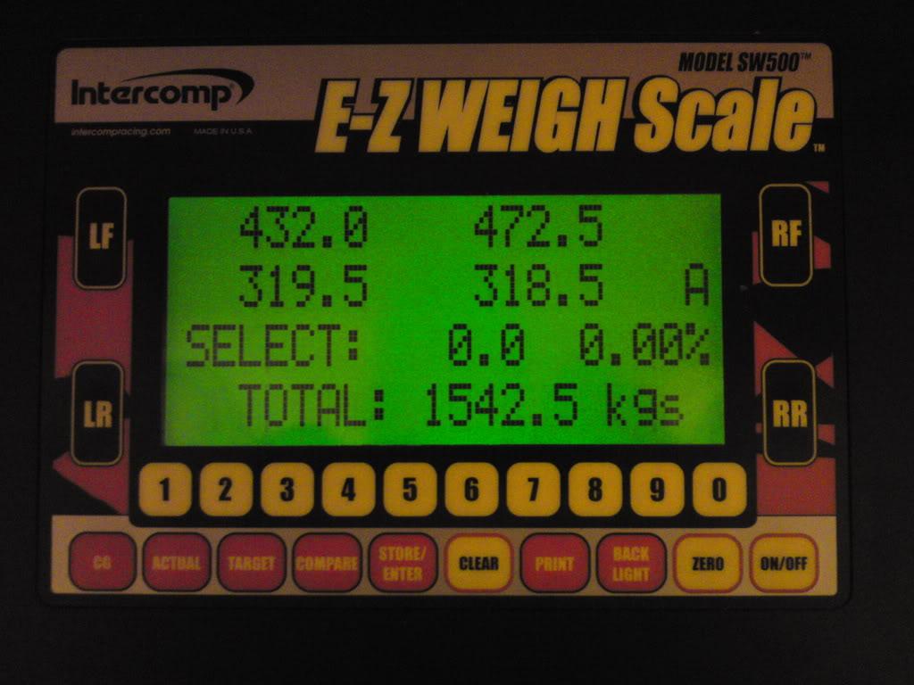

I got round to doing a setup on the vRS yesterday.  The car by itself weighs 1473.5 kgs with half a tank of fuel.  With my weight added to the drivers seat its 1541 kgs.  I could only adjust the spring platforms on the front as i have removed the rears to get the car as low as possible to get the weight at the back.  I adjusted the front as much as I could without messing up the ride highs.  Idealy I would have some adjustable roll bars links fitted then the corner weighting would be better.
Before with no driver:
Before with driver:
After with driver (I would have liked to get the front better as its more important than the back but the ride hights would have been way off):
Im also now running -2.5 degs at the front.  It feels great now and moving the weight to the back has reduced understeer loads.
