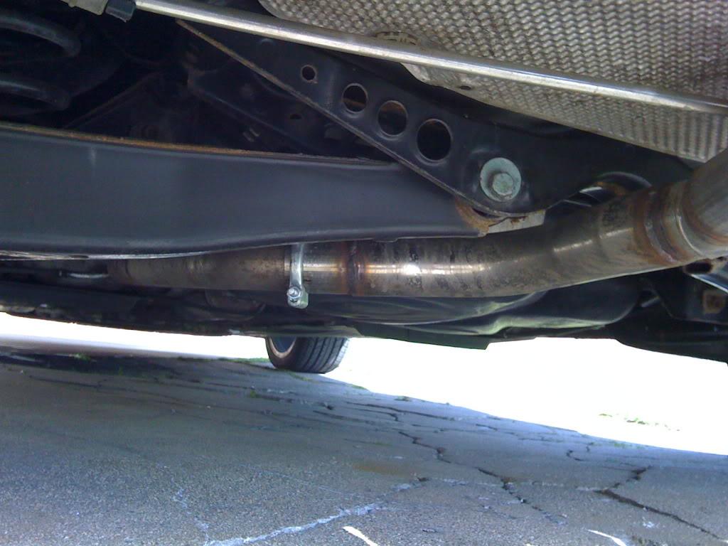

I considered doing this but for not much extra I got a custom rear section made up in stainless. We cut the original system at the proper VW marked place (see pics below) so if I ever need to put it back to standard its an easy enough swap. The added bonus is that it sounds really good (for a diesel)
