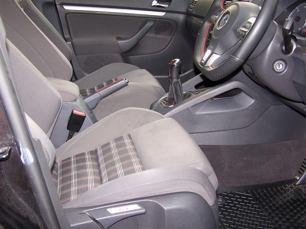

Time for an update
I now have removed the 729B skoda kit and have a 5N0 B premium kit
I have also added the Chrome fuel switch
Mirror Dip on Reverse
and thanks to Golfman I now have

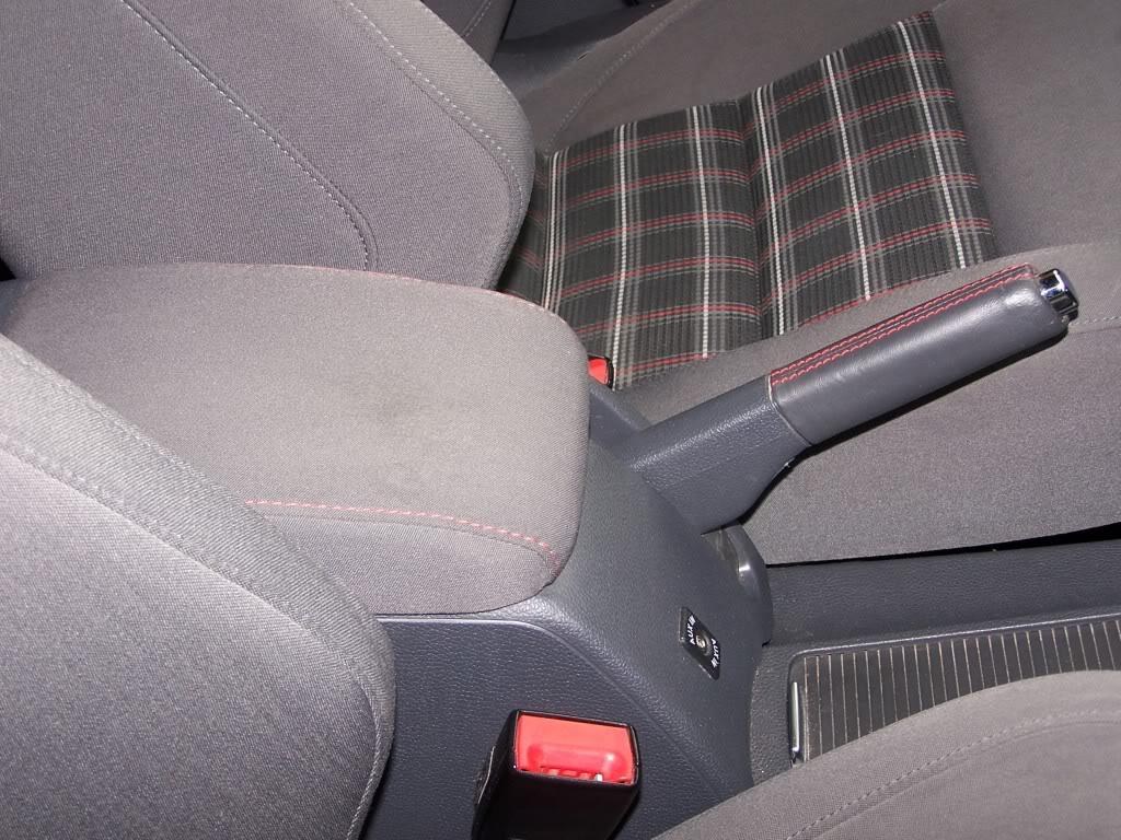

Red stitching on my Armrest top
Fully working Heated GTi Seats with GT inserts

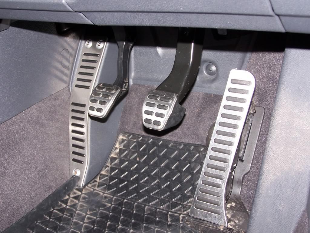

Osir Dead pedal and Gti pedals

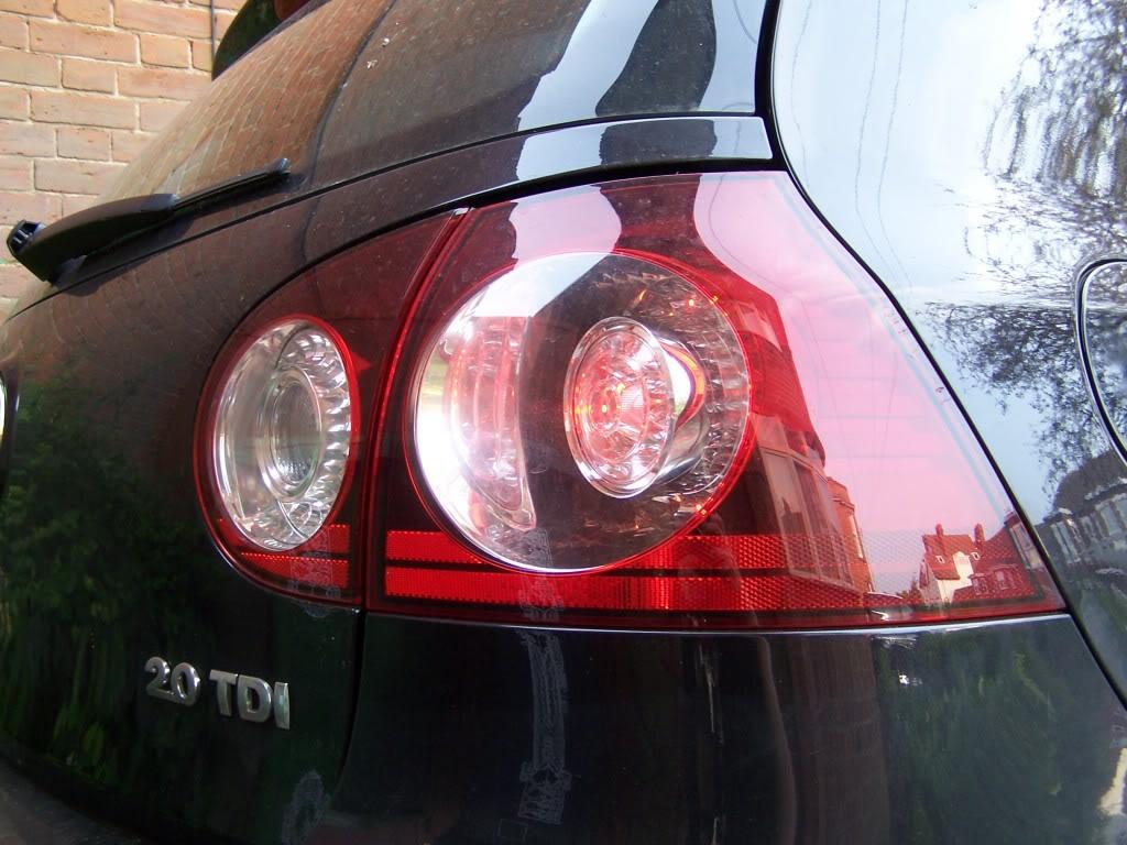

Valeo LED Rear Lights

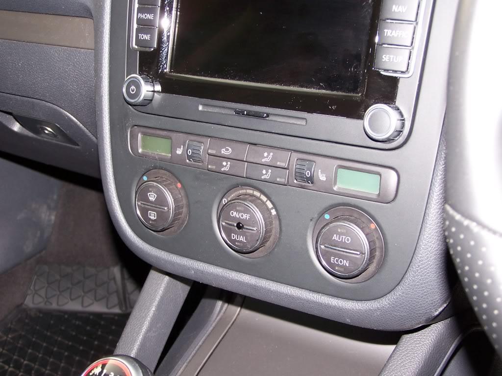

I probably will be trying the Mk6 Climate again soon

Were the seats difficult to do ? I have  Edition 30 seats in mine and would be interested in getting them to work properly. Heated and electric lumbar supports.

This is the 3rd set of heated seats that I have fitted. It is a time consuming process, but not too difficult.
lumber is easy to do, you will need a loom from kufatec and a new air con panel with the switches

Let us know how you get on with the Mk6 climate Eddie. I have done that, but I will be needing to rip my whole dash out to intall the one motor recirc system. Other than that, mine works a treat.

Have a look under your seats
If you have 1x control box near the front on the passenger side seat
you will want seats 2007 onwards with heating and lumber (sitzheizung & Lordose)
if you have 2x control boxes near the front on both seats the buy 2006
If you have 1x Control box you will either need to swop seat looms and control box (this is what I do)
or extend the loom from kufatec
