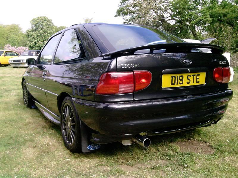

This is the car I own at the moment 1995 RS2000 and I used it for shows and over 1 year I only did 1500 miles in it so decided to get rid as its just an expensive polished ornament
The rs2000 at RSOC heaves Hotel 2010 Cumbria show
