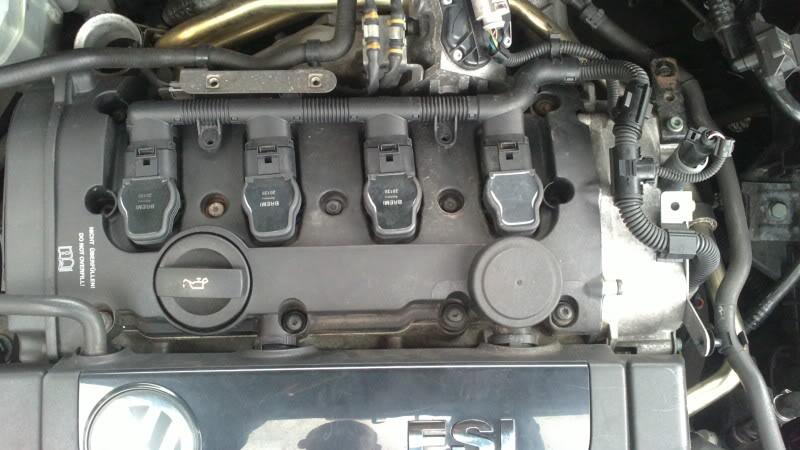

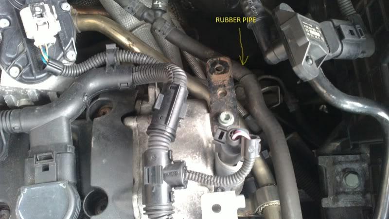

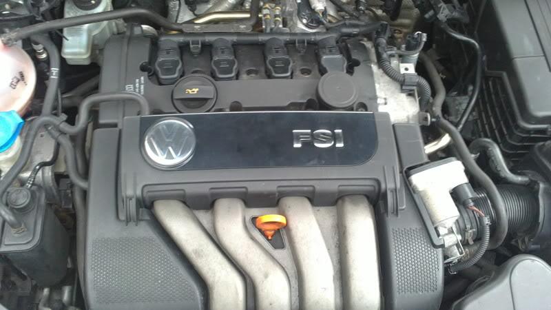

As title, I have a 2005 2.0 MK5 Golf GT FSi (not GTi) and looks like I have some sort of engine/coil pack cover missing from the back of my engine  :confused: also I have a rubber hose loose that catches on a metal bracket  :confused:
Here are my pics
And I have pointed out the rubber hose in the pic and the bracket is right next to it that it catches
Any info/advice would be appreciated  :happy2:

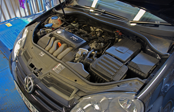

Found this picture on Google. Would appear you dont have anything missing.

Just heard off a ford forum Im missing
Quote from:
there should be a breather resevoir bolted on the top in the middle according to my VW guru, oh and two screws holding the coilpack/leads down, these are missing
Does anyone on here have a picture of a fsi engine bay like what Ive taken so I can see how that pipe is secured  :confused:

I Think it says in my vehicle data manual my engine version is BLX if ive read it correctly  :confused:
I wonder what holds that rubber pipe/hose in place in my 3rd picture then  :confused:

« Reply #6 on: May 23, 2011, 06:53:48 pm »
That metal bracket just above the pipe you've highlighted certainly looks like its there for a reason.  Looks clean where a bolt / washer might have gone through it recently.

« Reply #7 on: May 24, 2011, 08:51:50 am »
Thats what I was thinking about the metal bracket, just a shame I'm struggling to get hold of some clear FSi engine pictures to  look at that area  :sad:
There are holes there but it comes from VW without any screws like all the GTIs.

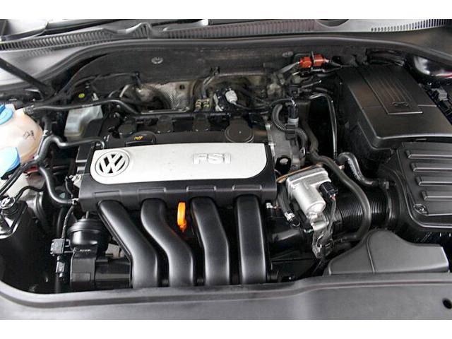

Have you tried Auto Trader adverts? Sometimes people post pictures of the engine bays . . . .
Good plan didnt think of that and have just managed to find one now, just a shame I cant zoom in on the area to have a look at the bracket  :happy2:

Here is a top view engine bay pic from autotrader
Here is my engine bay pics
