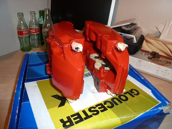

Can't get pics up as im on my phone will add later, changes since christmas have been cleaning related as I've got myself a da polished and had one session that achieved 40% correction not bad for a first attempt but will give it another go once the weather brightens up.
I have also spent this weekend refurbing my brakes, I ended up chipping the old paint off with a knife!  :surprised: this got me back to the original porsche and after the first coat they looking good, they will be sanded down once fully hardened and given a second coat in a week or two  :smiley: only issue is the transfer pipes  :sick:

« Reply #77 on: February 20, 2012, 01:28:57 pm »
Thanks ben, its not the how too thats the issue its the phyiscal they dont want to come out!  :scared:
Pics as promised

So over the weekend I had another go at the calipers over the weekend, and with the right tool 10mm flare spanner I got one of the bridge pipe off without any issue or damage, the other didnt want to move and the bolts eventually ended fully rounded off (its very soft metal) in the end I had to hack saw the pipe and hammer a socket on to the bolt to finally get them loose and once the initial stiction was cracked they came out perfectly.  :pomppomp:
Ive then given them a further coat of paint and they are looking great and are sat in the warm while the paint hardens.  I have already got a pair of new bridge pipes on order, now just need some pads and anti rattle shims before fitting  :smiley:

« Reply #82 on: March 25, 2012, 09:03:00 pm »
Brakes have had another coat of paint and been baked in the oven to harden them off, re-fitted the transfer pipes going to leave them un painted as they make a good contrast to the red and will be easier to remove if required later.

Thanks dave its been really satisfying doing the refurb myself it didn't feel like it as i was rounding off the transfer pipes but the finished article is looking good.  Thanks for the tip on the bleed nipples I managed to get them loose fully intact and swopped over with the transfer pipes. Next up will be to clean up the discs  :drinking:
What do people think of the un-painted bridge pipes?
Dave if you read the thread again I assume on porsches they aren't coated so they shouldn't corrode or would I be best to cover them in something?  Would you also have any recommendation to seal the paint so that brake dust cant bind to it?  I have seen some great white high temp sealant or is there something brake specific that you know of?
« Last Edit: March 27, 2012, 10:17:16 pm by Richn83 »

« Reply #85 on: March 27, 2012, 07:23:08 pm »
Uk painted bridge pipes will be fine, they are unpainted on the boxster.
Regarding the lacquer, we powder coat in a Matt finish and then clear them with a heavy duty anti vandal lacquer made by Akzo Nobel, it's pretty tough.
I'd just suggest some normal lacquer with a couple of coats keeping in mind it's calipers and not your bonnet....
