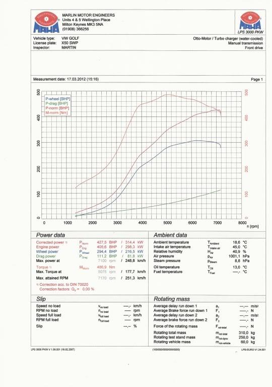

^^^ And my wheel horse power on the Merlin Dyno is here -
Not sure why the different correction factor, will drop Keith a line  :happy2:

« Reply #1071 on: July 02, 2012, 10:17:23 pm »
Just reading up on correction factors...SAE is American but seems to be as accurate if not more than Din 70020!
So for extra 18 HP at the wheels, you've got 41 more from drive train losses!
Something weird there

Hey everyone!
I'll show more graphs tomorrow. Using Din corrected more than sae.
The biggest reason for the high drivetrain losses were the iats.
Roughly, dans was 42 without meth, 31 with meth and Steve's was 59!!!
Our dyno reads production stage 3's at 37x, stock s3's at 268 and lots of others at what's expected or same as marlin's.
It's used for cal and power verification for the VW Cup so it has to read the same as marlin's and is meticulously maintained by Maha UK (they will be there in the morning even, 4th visit since it was installed checking and updating).  :happy2:
