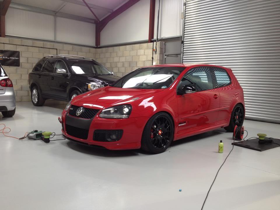

Full pics of the end result of the detail to follow but here's a pic grabbed from DMR's Facebook

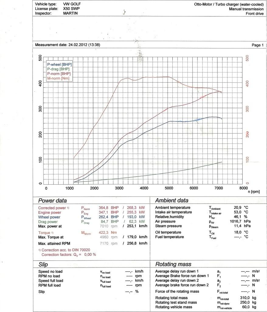

Keith arranged to get my car back on the dyno today to see what the final calibration was now making, so back to Marlin again and here's the final results: -
Before (done a week or so after JKM)

 :surprised: bloody hell 427hp
 :congrats:
Stock internals?

holy cow, that's serious power Steve, if those are stock internals perhaps there is more room there than many previously thought  :congrats:

Yes still on stock internals, once it's back from the Ring it's going in for IE Rods and Calico coated race bearings  :smiley:
Then the extra boost, fuelling and timing that's available can be unleashed  :evilgrin:

60 bhp more than me but 30 NM less, so internals can handle more Steve, no need for other rods yet.
What pistons are you considering for the IE rods?  :drinking:
