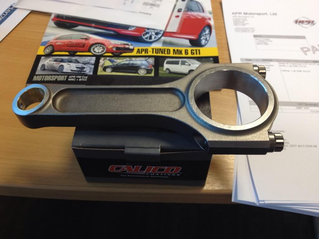

And the next mods ready to go
Integrated Engineering Drop In Rods (Riffle drilled) and Calico bearings, a set of ARP Head Studs will also be fitted at the same time too, then bring of Stage 3 +  :driver: :driver:

« Reply #876 on: March 23, 2012, 10:03:31 pm »
Tuscan rods?

« Reply #877 on: March 24, 2012, 07:35:27 am »
Tuscan rods?
Nope just the standard ones  :happy2:

« Reply #883 on: March 24, 2012, 07:15:00 pm »
Tuscan rods?
You sure they are IE rods?  IE drop in rods are H-Beam, but the ones in the pic are I-Beam?   :confused:

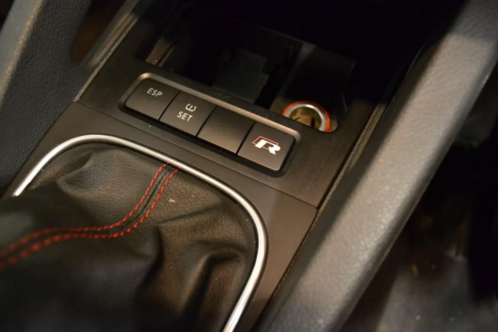

Some more little tweaks this week
Exhaust valve controller completed with an OEM style switched added to control the override function

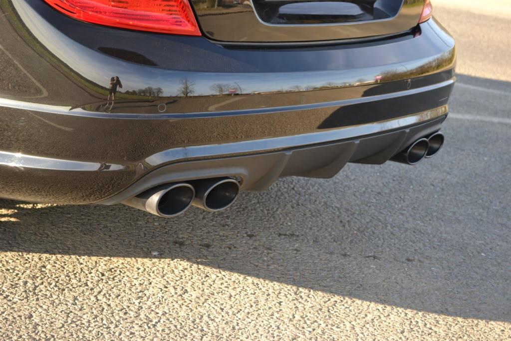

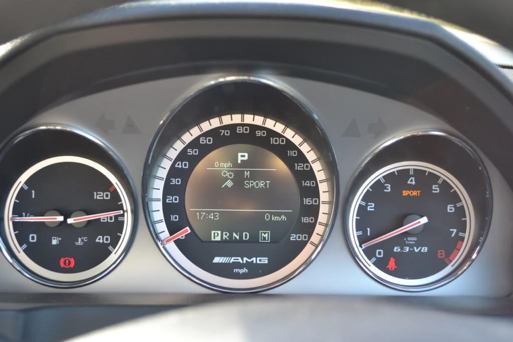

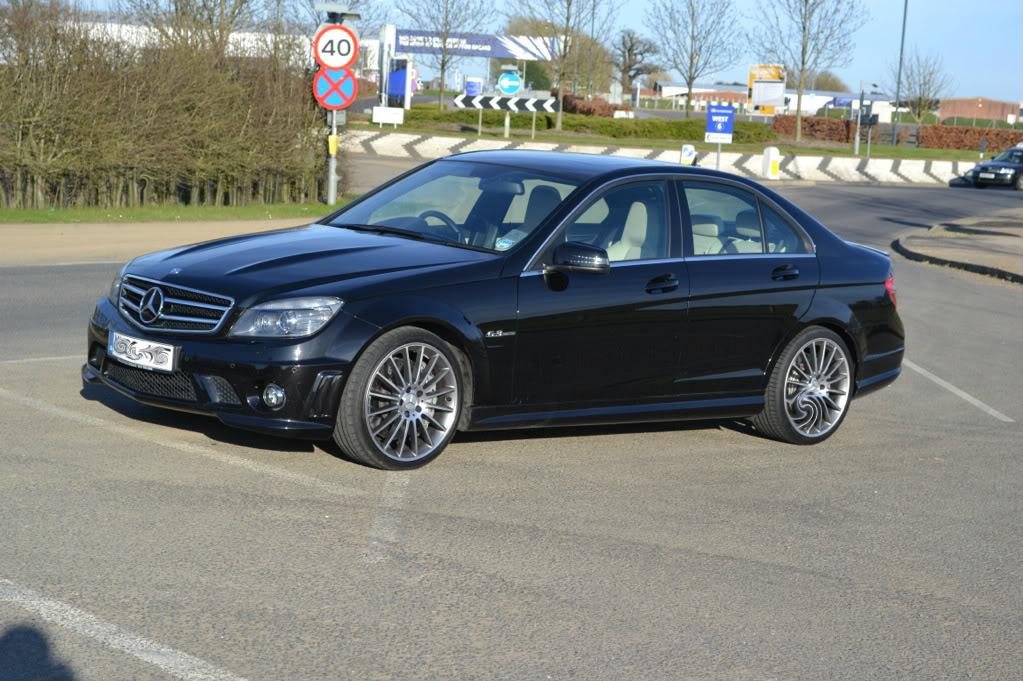

While Milltek where finishing off some tweaking to the system they kindly gave me access to something a little different  :drool: :drool:
To say the noise was addictive would be massive understatement  :party: :party: :party:
