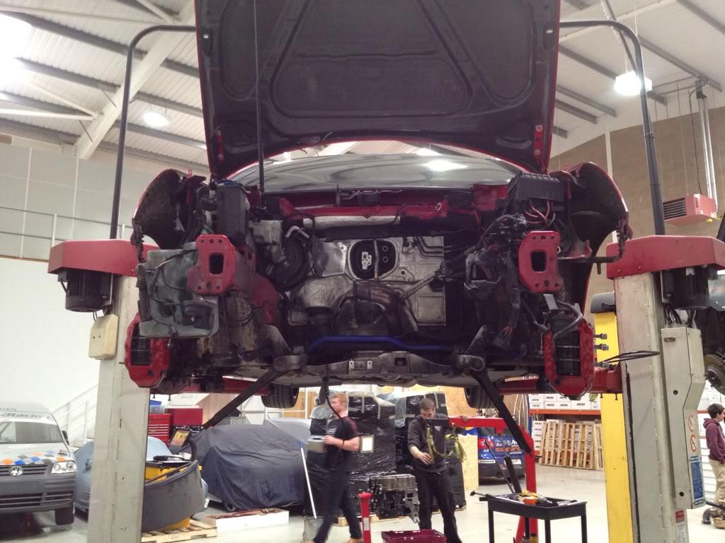

« Reply #943 on: April 15, 2012, 05:42:52 pm »
Should hopefully be getting the car back this week, popped in to see it this week and found it looking very sorry for itself  :scared:
Engine was on the mount in the background ready to have the sum removed.
Good news is no damage to the pistons and it looked at that point the cylinder wall was OK too.
Also checked the valves and the rest of the head and all looks in great condition, temping to get the head done while it's off the car  :innocent:

What work can they do to the head Steve?  Normal flow stuff?  Or can you optimise it for some wild cams?  Valve size etc?
