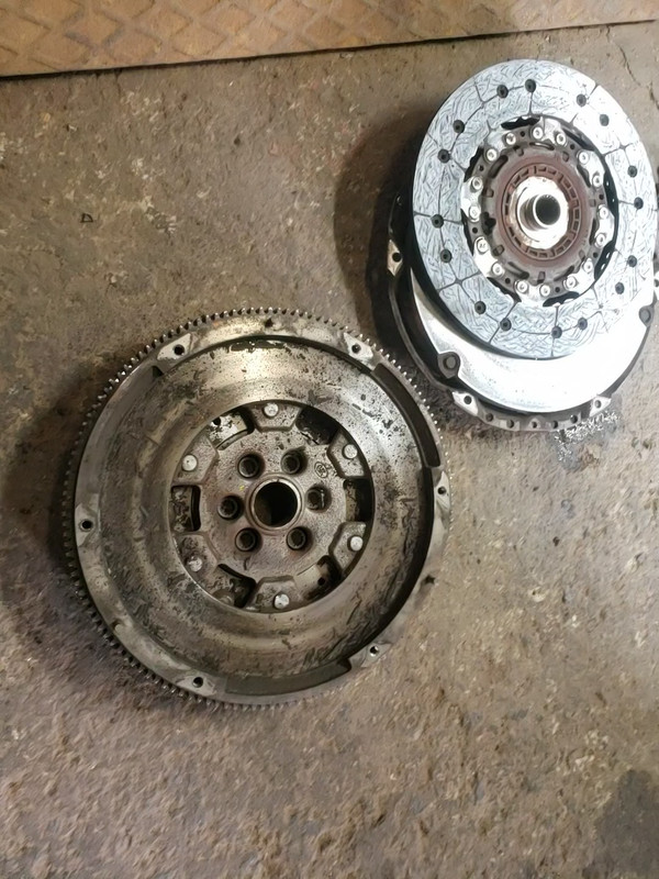

Had a helix organic clutch fitted + new DMF yesterday after getting a whole load of slip. Original clutch and DMF in attached picture. We were surprised that the clutch plate didn't look worse but the DMF was absolutely trashed - in addition to the usual rotational play (that you get with the new one anyway) it would also happily wobble off its axis which we think was what was causing the clutch to slip under power as opposed to the clutch plate being badly worn. In all fairness it's done well considering it's had 120,000 miles on it and a couple of track days. Though it's making me wonder if I could have saved a few quid (and my left leg) just chucking a new OEM clutch in there as the car isn't putting out silly torque figures. If that's the case then it seems the DMF is as much the weak point in these cars as the stock clutch, and if you can get away with a stock one not slipping for the usable life of the DMF then there's probably not much point in going for an uprated one and the heavier pedal feel that comes with it.
