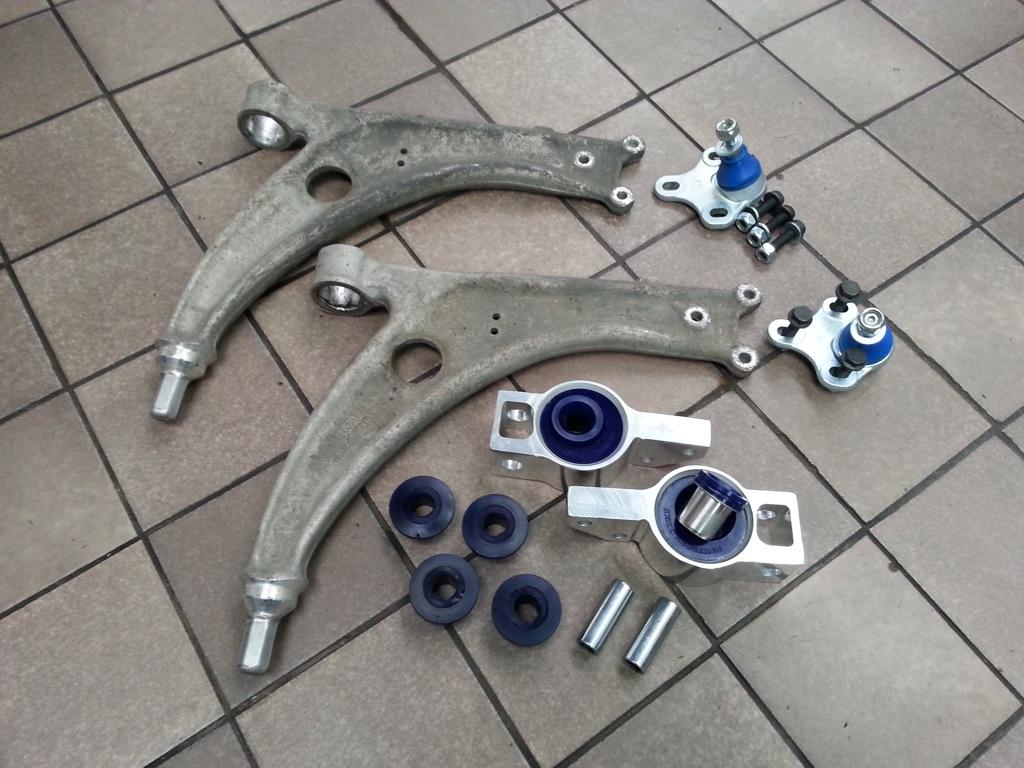

Re: Tfsi Mikes Money Pit :: APR Cupra :: SuperPro explanation
« Reply #2064 on: March 26, 2013, 08:29:02 am »
So the MkII TTs lower arms where removed.
On the Leon the TT arms position the wheel closer to the where the bumper and the wing meet on the Arch.
Despite Alex at AKS Pulling, Rolling, Spacing my front wings I'd still get ocasional scraping and on track wouldve probably happened even more.
The TTs Arms are a great mod for the Golf with the adjustable ball joints just turns out that theyre not suited to the Leon.
I had the Cupra arms re -fitted;
With some SuperProball joints.
Haven't had chance to test this new setup yet but reckon it's going to be great.  All round adjustability.  Will report back after the next trackday.
