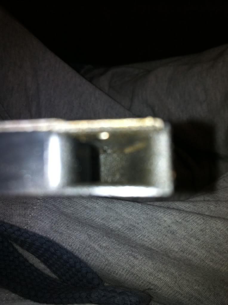

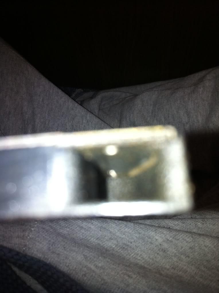

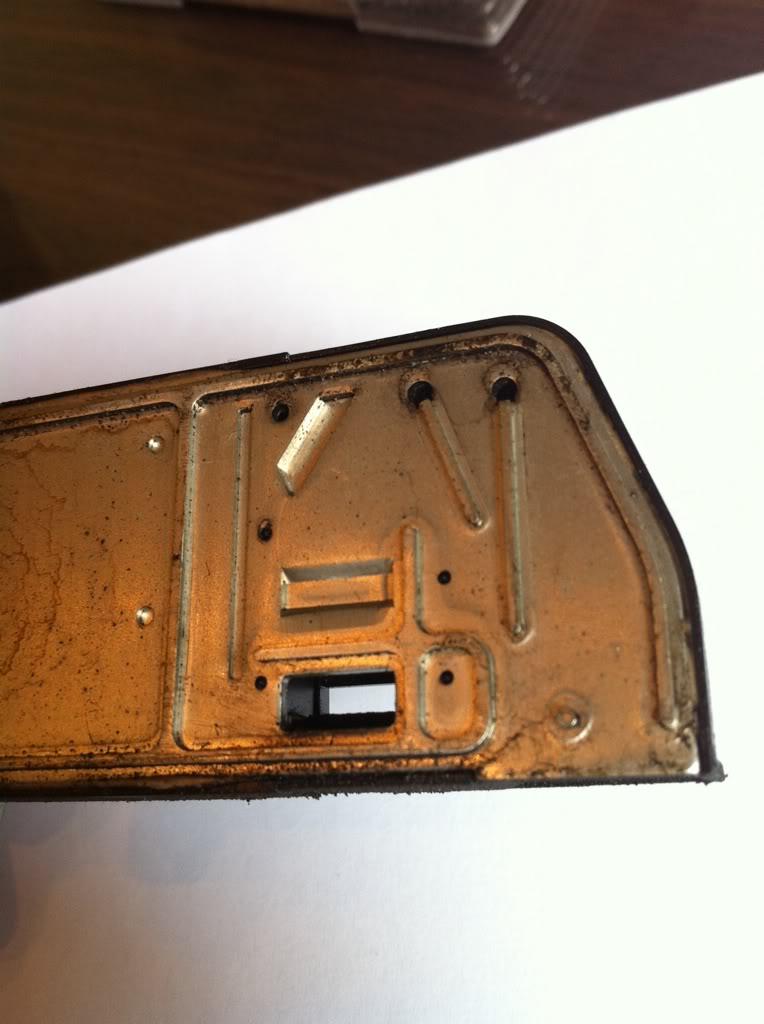

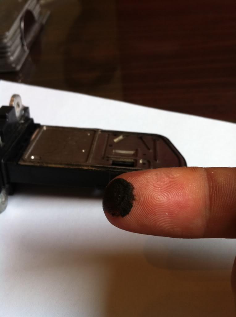

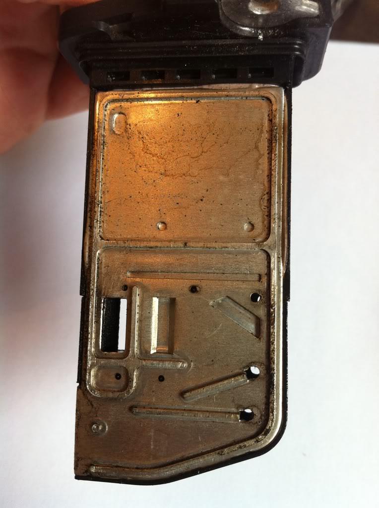

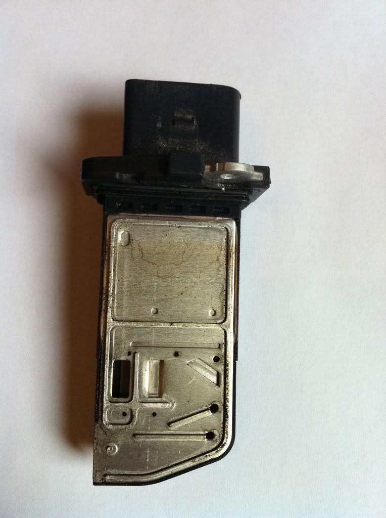

Whipped MAF out to have alook.  Plug connections look fine no corrosion etc after all the jet washing.
However there was a fair bit of resudue on the body & inside the sensor itself

What filter you running?
Took my airbox off yesterday to fit ITG filter and my maf was spotless...?
