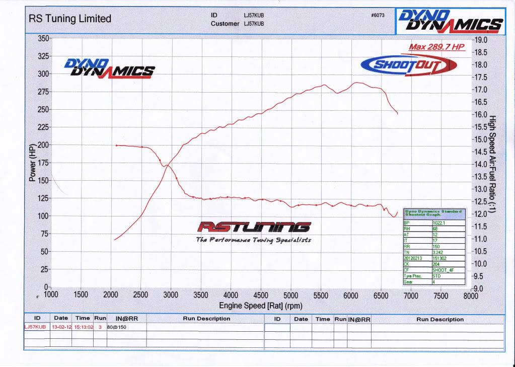

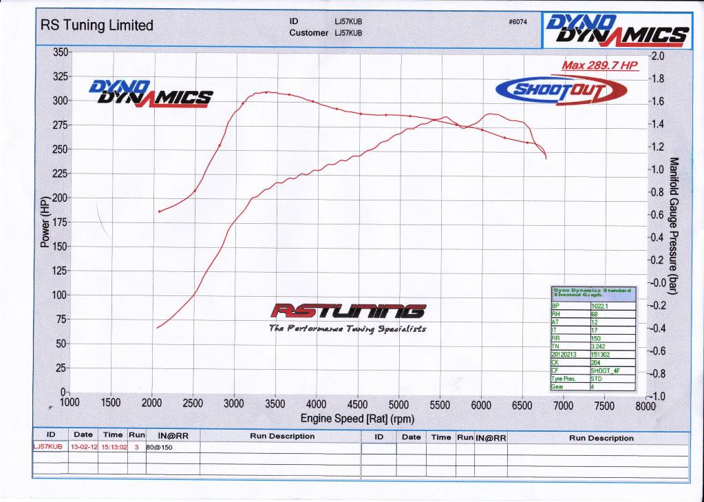

Scanned the graphs...
Says @ flywheel so subtract 15% for 296hp @ Wheels ??
Tapped into boost guage
AFR

289hp would be wheel power yes so more accurate?

^^ Would the AFR graph be accurate if I have a faulty Lambda post cat sensor...?

Yeh that would make sense as mine made 330whp on numerous dynos, obviously the golf has more transmission loss but where have they got that 289hp from?

Clutching at straws but is where boost and power cross over on Manifold boost pressure graph??

289Whp with 17% losses is about 338Hp so its about right for mikes graph
330Whp is about 386hp.  Now that is unrealistic

My friends jabba car is going APR stage 2 plus, and we are all sticking our cars on a rototest hub dyno early june, will be interesting to see what it makes.
Whats going on with the dip in power at 5700rpm? Other than that its got nice high rpm power holding

Will go on hub dyno next time im in Doncaster.  Will probably be Mid March  :happy2:
Not sure about the dip.  I saw a similar graph on the JKM thread.
So long as the car is safe, im happy with how quick it feels.  Just want linear throttle pedal, my diff fitted & some decent tyres.

Nothing to worrie about there with that graph, Mike. No evidence of surge at all  :happy2:
How would it manifest itself in the graph & on the road?  :happy2:
It would feel as if the power dropped off then came back on. On, off, on, off..
It would show up on the graph as dips and peaks, just like it is right at the top of the graph (but thats nothing to worrie about)..

Yes it'll still be accurate if your front lambda sensor is ok.  The post cat lambda sensor is there for emissions only.  It measures the oxygen stored in the catalyst so the ecu can tweak it rich or lean to maintain cat efficiency.

Going off the graph the map goes BOOOOOOOSSSTTTTTTTTT, flutter, flutter, flutter, flutter, flutter (wavey line), Fuel pressure drop (at 5.5k) then its run out of puff at 6250.
Need to see what that boost is doing, the requested vs actual and the wastegate duty.  Runs leaner than I would expect too, and its working the turbo too hard when its coming on boost.  Flutter is the DV trying (and struggling) to control the boost by opening and closing.
Just made to feel fast rather than drive smoothly and nicely esp without linear throttle imo.
Is there a graph with the boost on it?
Would you mind logging it when in for diff please Alex?
Graph with boost tap on manifold is on last page (middle one)  :happy2:
