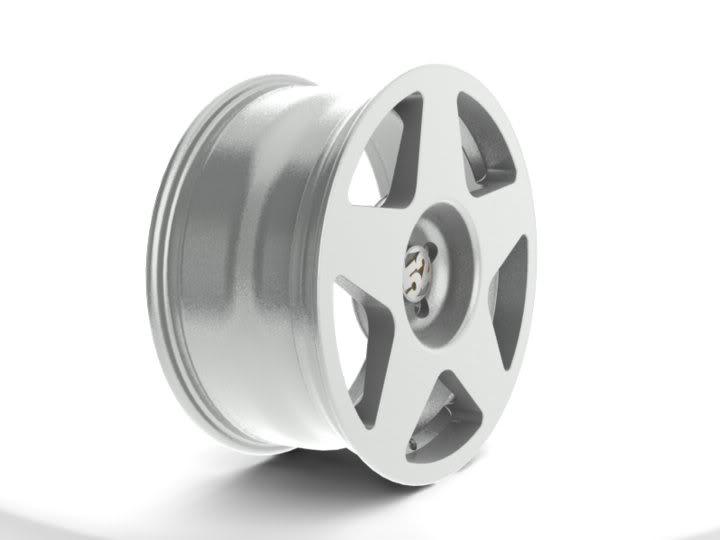

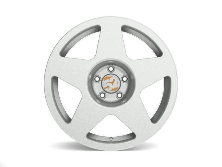

ok so as im having my new air ride fitted soon  :jumpmove: :jumpmove: ive also decided to have some new alloys, these beautys. the fifteen52 tarmac`s
but my problem is i have a friend who has a bodywork repair shop who ive had some alloys sparyed b4, which look awesome, really top job    but they dont do powder coating  :s
now do i take the alloys for a standard paint spray and get mates rates  :laugh: or do i pay that bit extra and go elsewhere for a powder coating?
im going for a lime green colour lol  :rolleye: not to everyones taste, but i need to be different and they would look pretty sweet on my slammed candy white
i dont rerally know what the advantages of having powder coating would be so any help would be much appreciated

mike: when they came out i was like oooooo i gotta get me some of those  :love:  i believe they weigh 27 lbs
robin: so is it how the powder coat paint is actually applied determins the durability of the paint?
