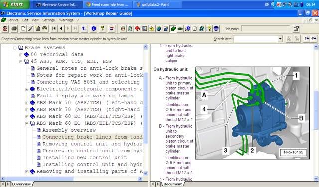

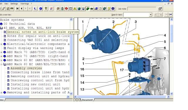

Dave i can look on elsawin if you like i was actually looking at the master cylinder and abs plumbing on there this morning? Unfortunately im at work at the moment but can get you every thing first thing,
Right see if this helps Dave

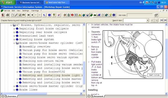

And the switch
