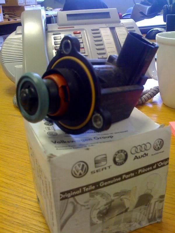

Felt this go pop in the week, t'was p***ing boost like a good-un! Luckily I had a type-G in reserve for a quick swap-a-roo.
No fault codes/warning lights (although VCDS logging or a boost gauge would have obviously shown the drop), just the butt dyno and keen hearing in my diagnostic toolbox!
Sideways yo!

what sort of mileage had that done?

28K, 19k of which it has been mapped... its two and a half years young.
I don't see the point of the Forge one for a K03, unless you want a boost gauge.

Is the G revision the new piston type valve??
My valves were blowing every 4-6k miles on my K03 GTI until I went Forge..

Dunno about the ins and outs of a Ver G Jonny, but if I got 2.5 years out of a C and at 1/5th of the price of a Forge - if the G is better, then I ain't upgrading!
x2 I kept blowing B and C revision gauges until I swapped for the forge unit. This G unit (haha) is meant to be very reliable though.
the G revision has just been replaced, got my DV changed today.. dont know what the difference is though

Newest DV revision D : 06H 145 710 D

Should be printed on the DV in white lettering.
Mine's got the VW and Audi symbol and underneath it:
06F 145 710 C <---- C being the version.
5900 110 7044
7.00415.03      APG
