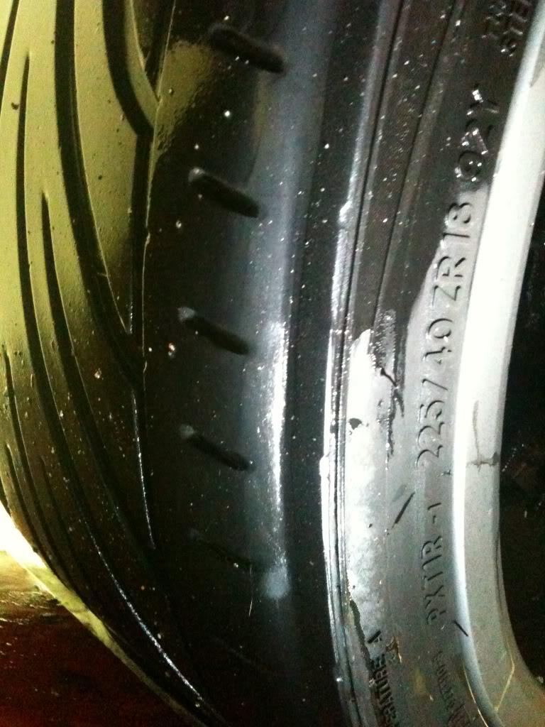

same thing happened to me when i got  my Weitecs. turned out one of my tyres was defective. (sidewall didn't meet with the tread properly for about 1/3 of it's circumference.)
having the car lowered accentuates these sorts of problems. your tracking may well be correct, so look for other possible sources for why your car doesn't drive in a straight line.
happy ending to my story - Audi replaced the tyre FOC. drove straight and true after that.
