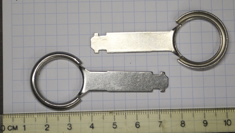

using keys like this of credit card cut-out equivelants like I'm using:
p.s.Not my pics hence why I don't have the keys to use.  :sad1: Would make this job so much easier as the wee credit card equivelants keep breaking.  :sad:

You could maybe have a go at making a set up,the graph paper and rule give you a good idea of size and scale.

I did make mine own up last night, out of an old subway loyalty card! Don't mock my mad MS Word skillz!!  :wink:
_________________      ___
         A                |__|  C |__
                             B         D|
                            __       __|
_________________|    |__|
A=28mm
B=4MM
C=2MM
D=2MM
Sizes are very rough. If you adjust your window zoom level to 53% you can measure it yourself off of the screen.  :wink:
The small parts 'C' are liable to break easily so be prepared to make a few extra and they are generally only single-use items if made from an old credit card.
HTH   :happy2:
