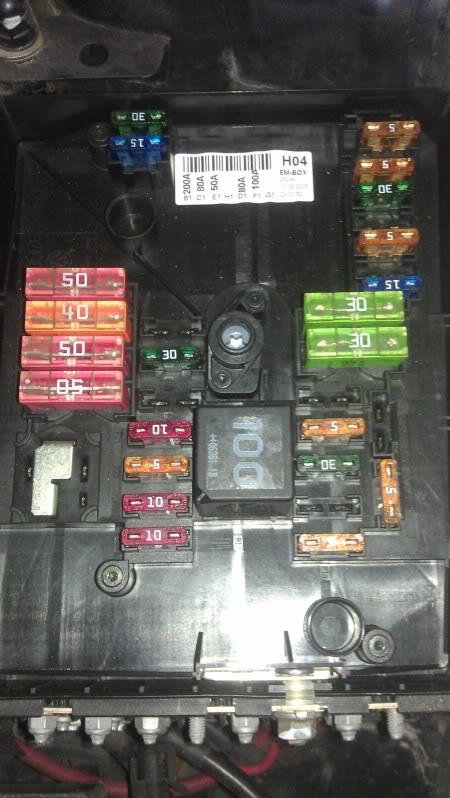

« Reply #6 on: November 10, 2011, 09:18:22 pm »

« Reply #7 on: November 10, 2011, 09:22:44 pm »
Handbook shows F25 and F26 to be the 2 big 30 amp fuses to the right of the screw thingy in the middle

« Reply #8 on: November 10, 2011, 09:26:04 pm »
You can see one of the 30amp fuses broken in the picture  :stupid:   :laugh:

« Reply #10 on: November 10, 2011, 09:42:56 pm »
 :signLOL: I was adamant all were fine under engine bay and must be one in the car. 1st job 2morrow morning. These rewirable with house fuse wire or do you have to get a new fuse?

« Reply #12 on: November 10, 2011, 09:55:27 pm »
No idea. I given up for night and in bed. Im not the best at looking for things tho like this so I probally did miss it and it is blown. The cluster looked like it had better days so replaced that and hopfully a new fuse wont blow.

« Reply #13 on: November 11, 2011, 05:08:35 pm »
FUSE is intact!
DAM
No idea where to start. Anyone? Anyone know where to start?
