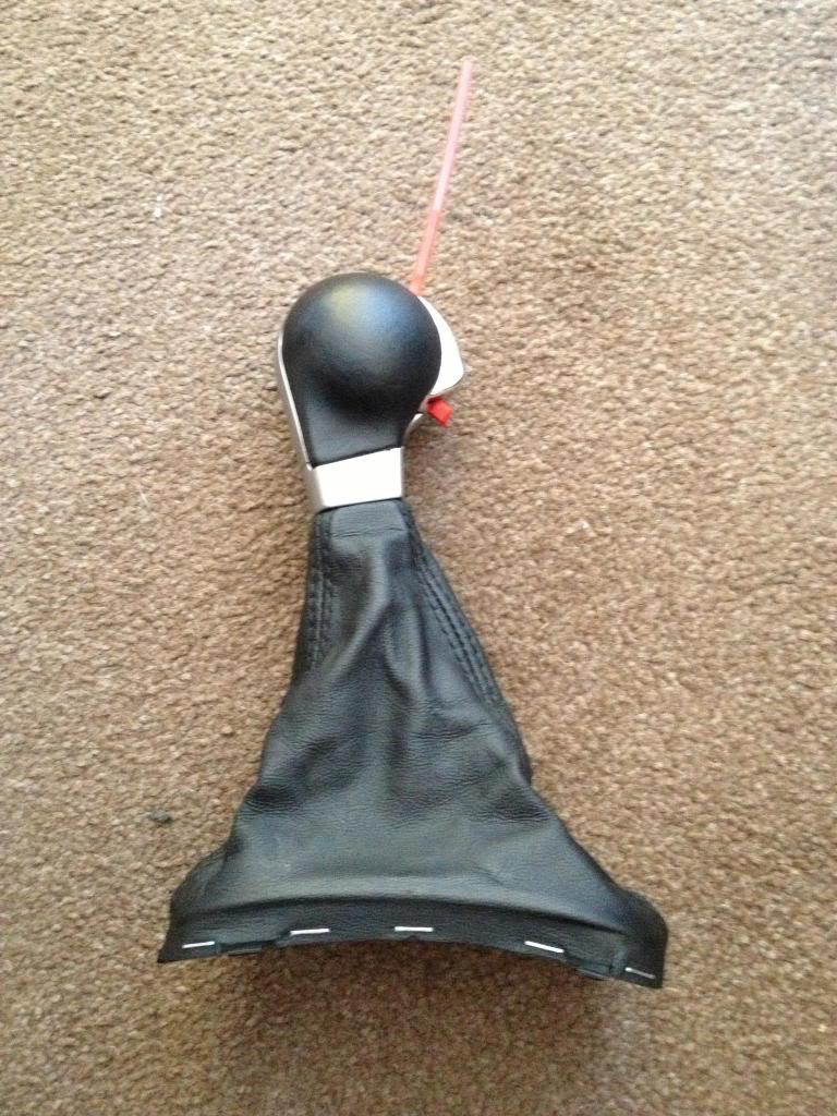

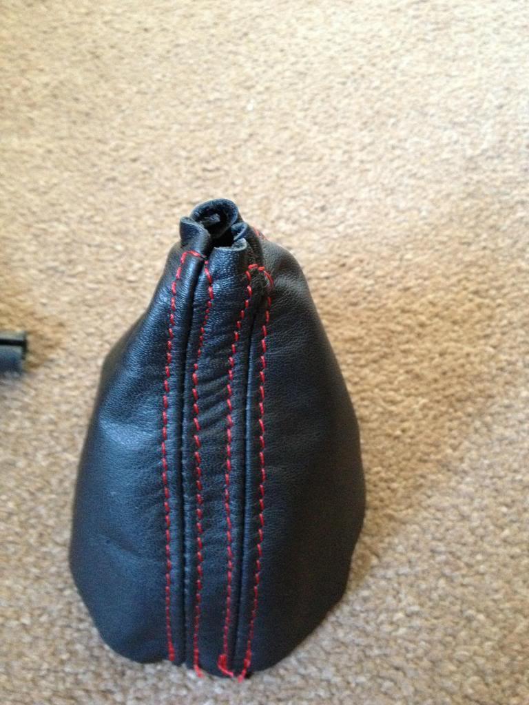

Hey guys, my DSG gaiter is look a bit old so decided to buy a new one with red stitching. Looks really nice but i really cant cant the old one off !!!

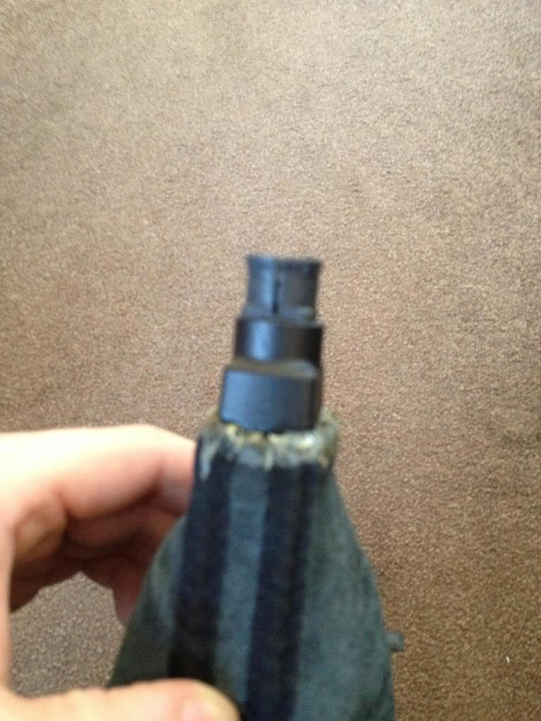

I followed a guide on here how to remove the gear knob from the car. but now its off, i can not remove the gaiter from stick, not sure if there is a release clip somewhere or just glued on, as there does seem to be a bit of glue around the top.
This is a much harder job than i first though  :stupid:
Here are some pics to show you, any help would be great.
Tie wrap in top to stop button going in.(from the guide)
New one i want to put on

Offline tommy_a
  • Posts: 103
Re: Removing / Replacing DSG Gaiter - Really Need Help !!
« Reply #1 on: January 26, 2013, 02:27:08 pm »
Only a guess as I've never done this myself, but does the end bit with the slot in need to be squashed together allowing the square bit to slide down?

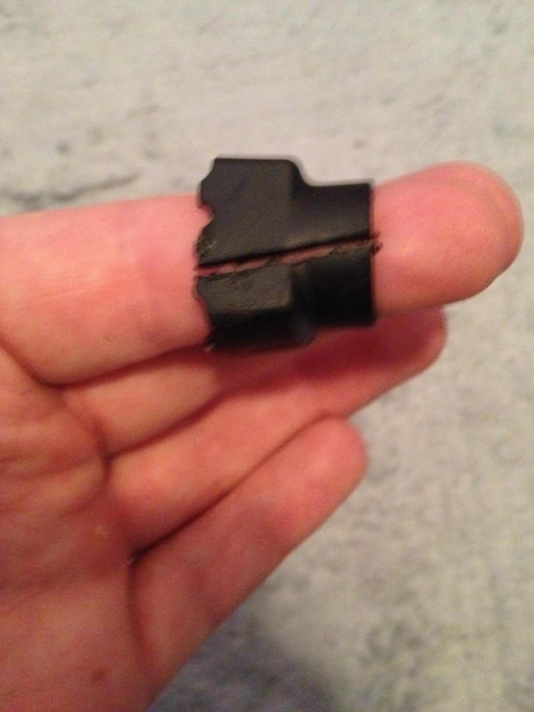

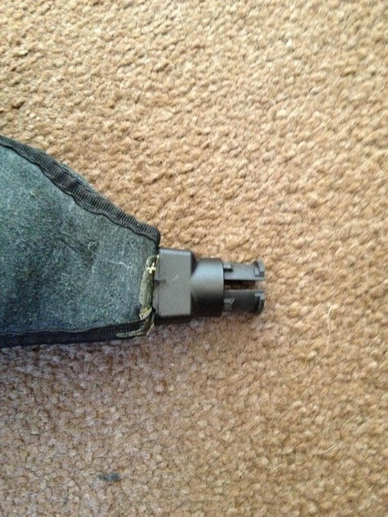

Ok, so the only possible way i could get the black plastic bit off was a bit of saw action.
Here is what i did with a junior hack saw:
I was then able to get this old gaiter off - thank f*ck - should have been an easy job.
Or well, so then simply hot glue gunned the plastic back together, back to new.
So if any one has this problem and cant get the clip of, give this s try, i will update title to, how to remove DSG gearknob

Yes, this is the only way to replace just the leather gator on my R32... Cut the plastic clip on the base of the knob. (I used a Dremel.)
