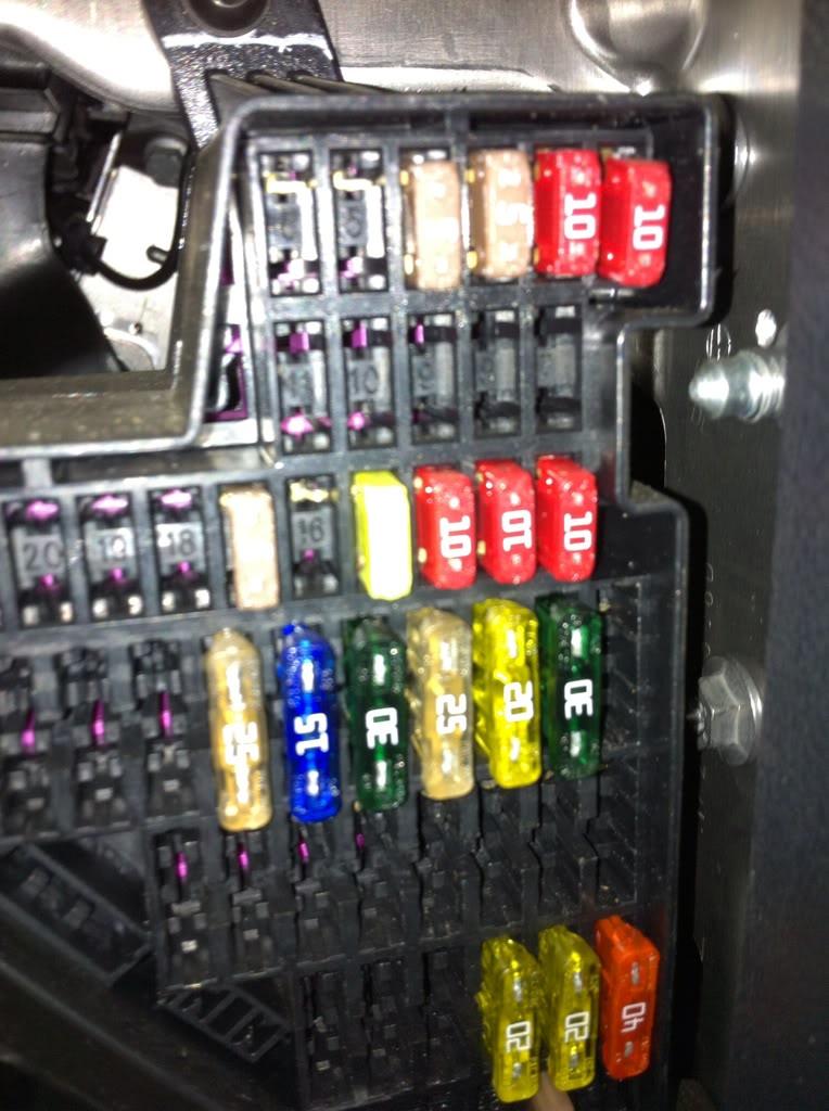

Does anyone now where I can find out what fuse does what on a mk6 golf estate.
I dropped a penny in the cig lighter by accident which made a spark. Now it doesn't work so Im thinking iv blown the fuse, but can't find a fuse map.
Here are the fuses

12v socket number 42
1 is top right and counts along to the left and goes down and starts counting right to left again on next row
Hope that helps
Hope that helps
Must add that is MkV / Leon not sure if mkvi is much different

Still number 42 :wink:
