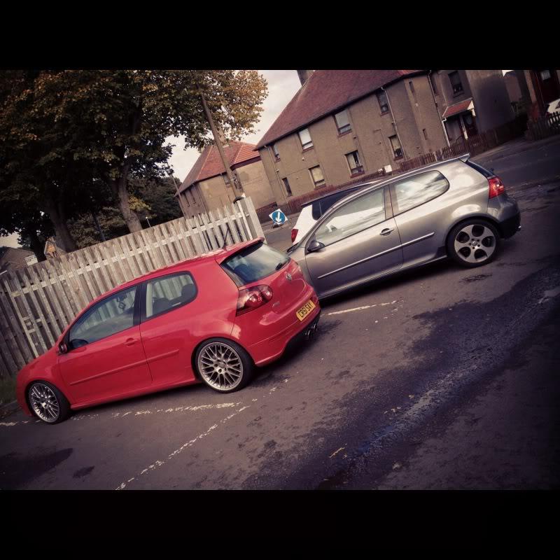

Just a quick instagram update from yesterday  :smiley:
Im stuck for my next mod now, I reckon it will take a while to get over the last one  :smiley:

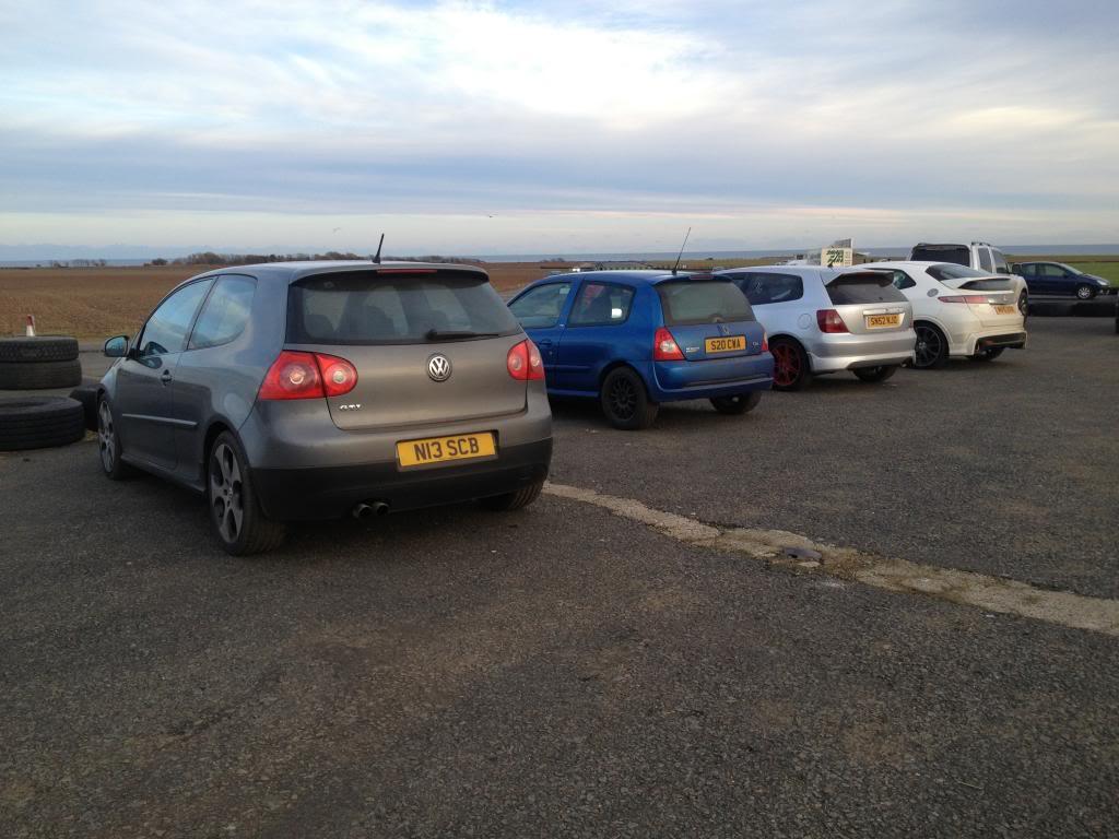

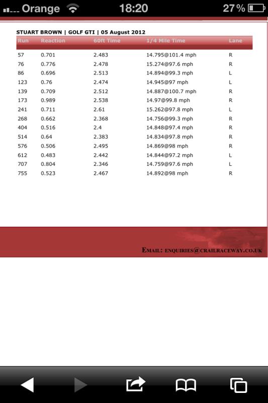

Update time...
On Sunday I had the car at crail for the first time since its revo treatment. My times were 'ok' but I was expecting a bit better to be honest. No matter what way I attempted to launch the car, I was struggling to stop wheelspin. I know crail isnt the best surface but tips would be excellent  :grin:
My dad has owned drag cars for years and he told me with a terminal speed of 100mph a high 13 is possible. I got no pictures but I got videos, I am still happy with how the car goes when rolling  :smiley: ( im not sure how to embed?)

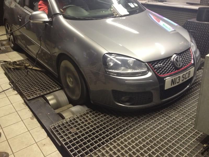

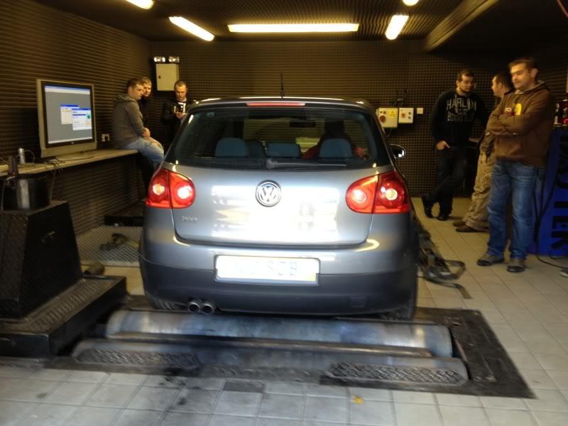

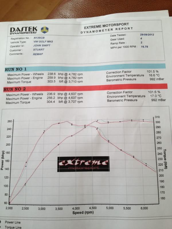

Small update...
Had the car at extreme motorsport for a scottish group rolling road day, im very happy with how the car performed   :smiley:
Compared to last time before my timing issue was sorted my graph looked along these lines....
And today when sorted....
Very happy with the power increase, just happy to see it on paper now  :smiley:
Think the next mod might have to be brakes!
Stu  :happy2:

As comparison my stage 1 ed30 did 14.14 @ 102mph with a boot full of gear. I think you will struggle to get below 14 seconds unless you remove a lot of interior and spare wheel and get a perfect run.
Offline N13SCB
  • Posts: 140
Re: My GTI. ( RR visit )
« Reply #72 on: October 01, 2012, 12:32:33 am »
Yeah I think going below 14 would be too much to ask at the minute.
I think with the correct launch and less wheelspin I could hope for 14.3 maybe  :happy2:
