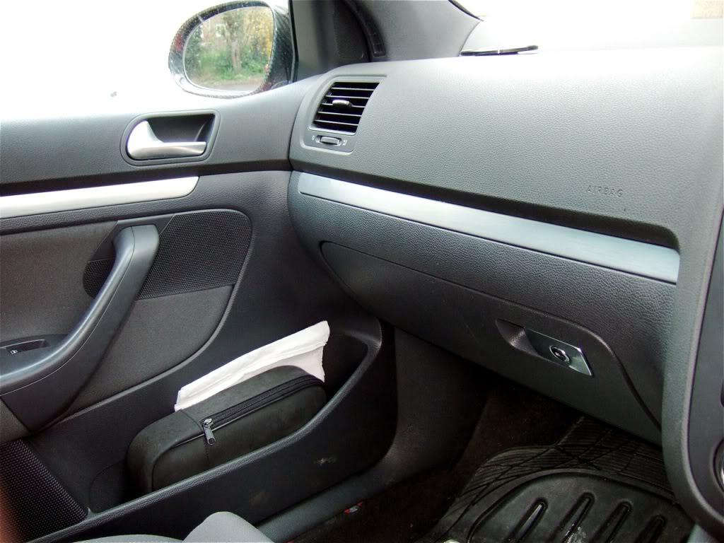

I'm talking about the brushed aluminium trim running horizontally along the doors and through to the dashboard.
All you need is one of those hard nylon tools and some controlled brute strength!
I borrowed an upholsterer friend's Bojo tools : -

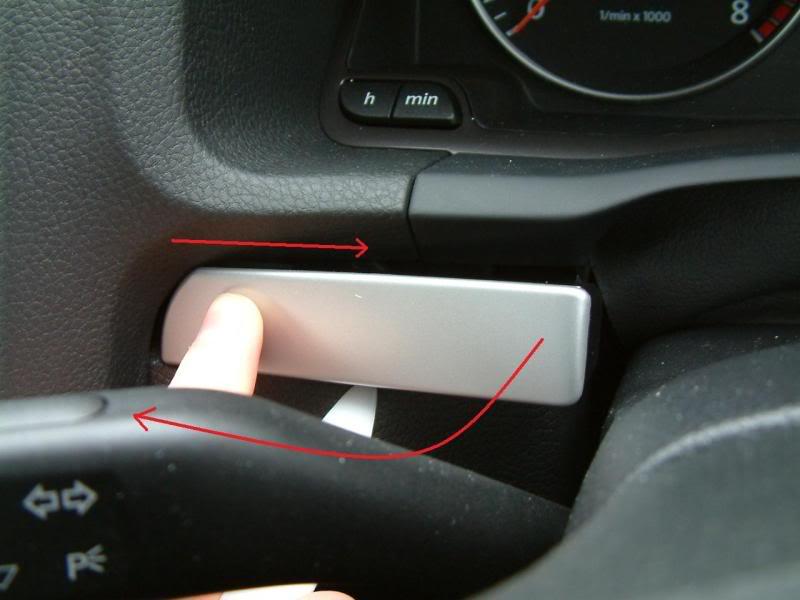

Insert on the blue Bojo's between the TOP edge of the aluminium trim and the grey door trim above. If you insert on the bottom edge there is a much higher risk of any leverage marks being much more visible. It's best to start about a quarter distance from the righthand side for door trims and quarter distance from the lefthand side for the dashboard trims. This is because there is a 'hook' feature at the extreme side.
Tackle the door trims first because afterwards you'll have a better feel for the slightly more awkward dashboard ones later.
At first you wonder how much strength is needed because those Germans really build their cars well. But once you've managed to release the first 'plug' fixing the rest will leverage out quite easily. Don't panic if you bend the alu trim - It can be easily bent back providing you haven't been extreme.

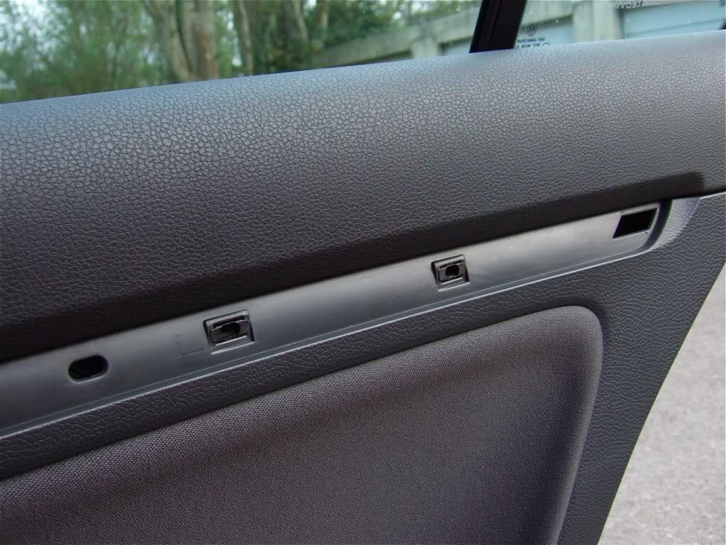

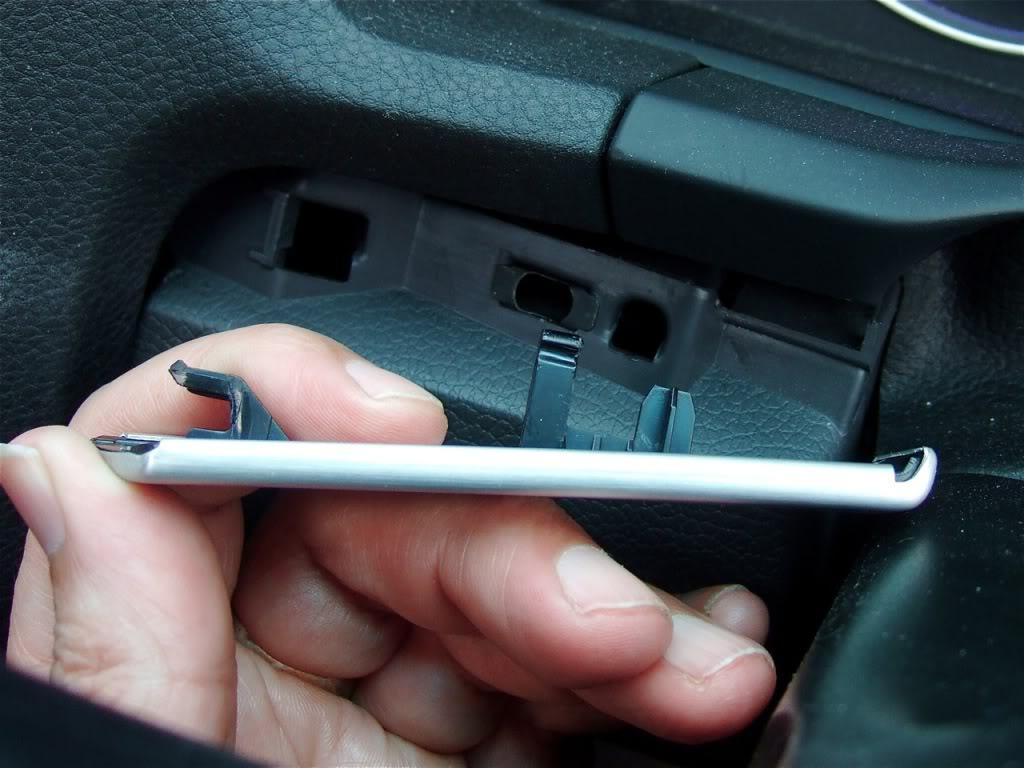

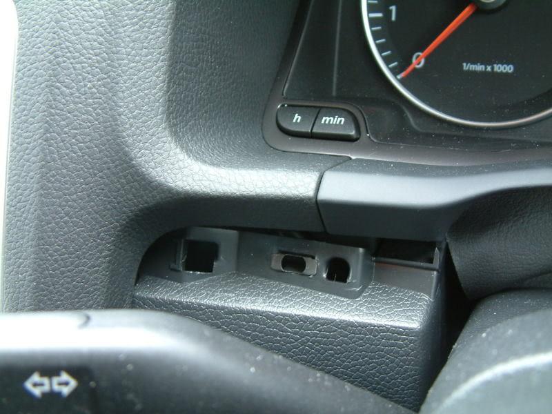

Take care not to lose the small female metal sleeves which fit between the male plugs on the back of the trim and the female holes on the door/dash. Some of these sleeves may pop out with the trim but just pop them back in the door/dash. It isn't possible to lose anything inside the door panels or dashboard, so don't worry! The sleeve is shown in the middle hole in this pic : -
Slide away from the hook side and pull outwards at a gentle angle. It'll ease out quite easily at this stage. The tricky bit is the initial leverage : -

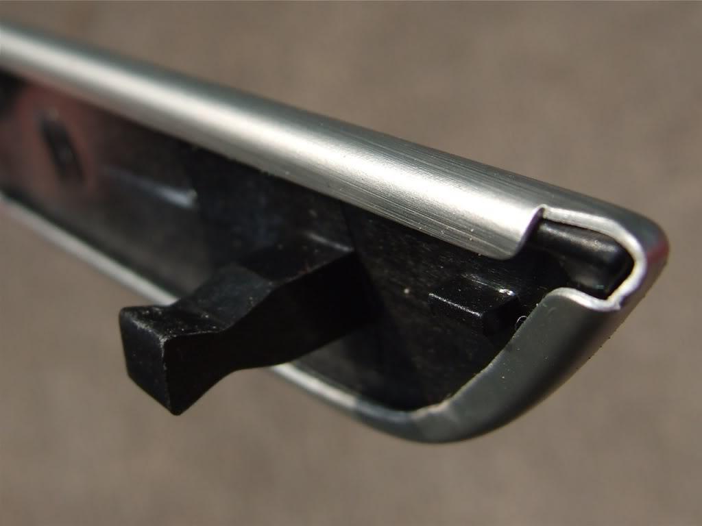

^ Showing the shape of the 'plug' and therefore the resistance as you lever the trim away from the door.
^ The rectangular slot on the extreme right is where the 'hook' fits. Also note the 'sleeves' in place.

^^^ Thats not your car is it Robin?  :confused:
Well spotted  :laugh:
Re: How To Remove Alu Strip Trim....
« Reply #3 on: April 17, 2009, 08:04:41 pm »

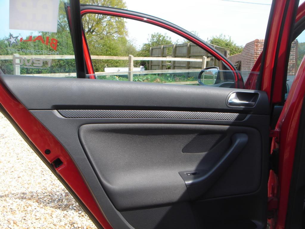

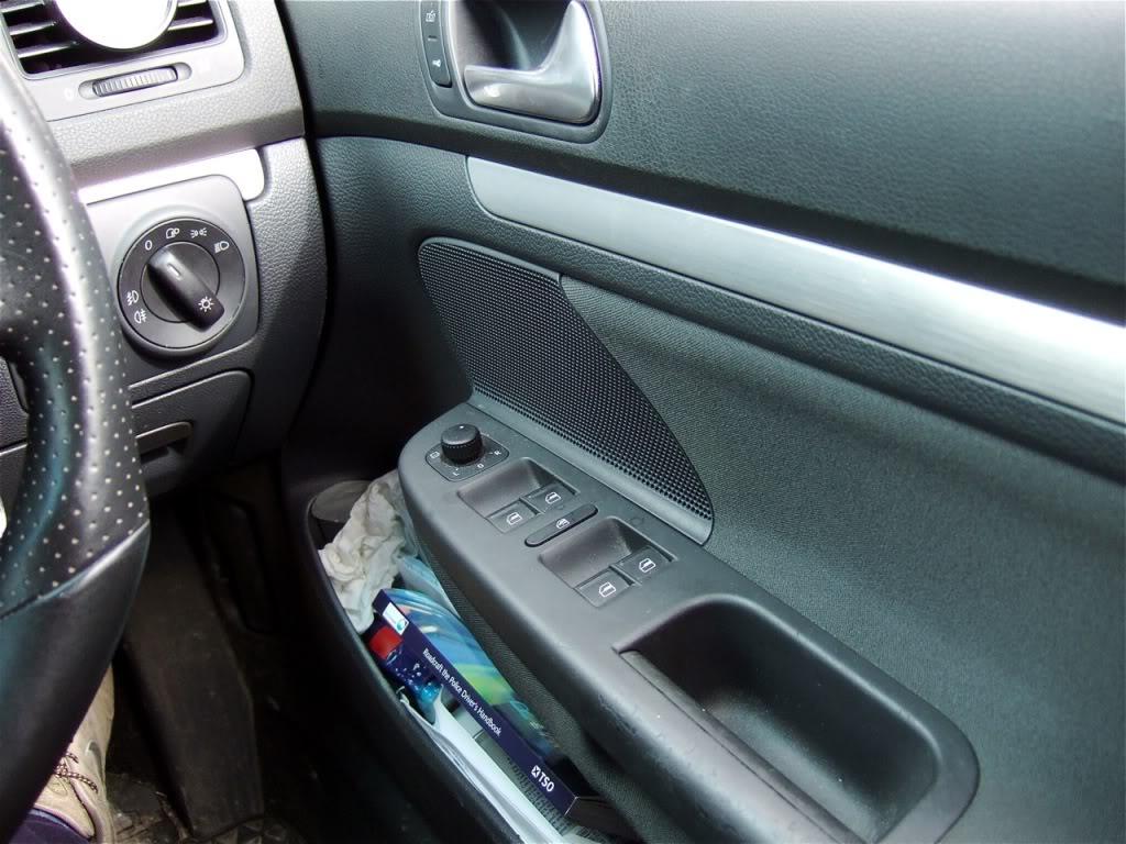

....The first 2 pics are of mine < Most of the pics are now mine. The others are of a Scirocco supplied by wigit.
Oh, and that's not me wearing that T-shirt either :wink:
« Last Edit: April 23, 2009, 08:01:39 am by RedRobin »
« Reply #4 on: April 17, 2009, 08:23:19 pm »
....The first 2 pics are of mine. The others are of a Scirocco supplied by wigit.
Yeh the one with the air vent pic in threw me!
