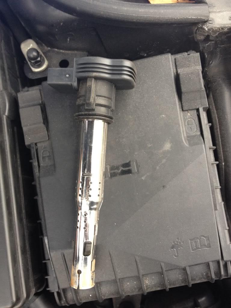

bought some NGK iridiums i had fitted today. (big shout out to National Tyres in Newcastle-under-Lyme for fitting them for free once i'd got the coil packs off.) incidentally one of the coil packs looked fubared:
thing is, it's from the 4th cylinder from left to right when looking into the engine bay i.e.
UK driver's side --- 1 --- 2 --- 3 --- 4 --- UK passenger side
if i'm not mistaken that's cylinder 4, and my misfire is on cylinder 3. all the other 3 looked shiny and new

I have pics from nearly every coilpack change and cylinder 4 is ussually minging.
Scaly down the coilpack hole and rusty sometimes round the edge of the coilpack.
I have no engine cover which makes it easier for water to ingress in there, the Leon is also renowned for water leaing between the scuttle and the bonnet and leaky washer jets.  :fighting:
