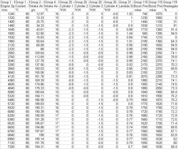

Here are some logs I did today - the first time so a bit of a learning curve!
Managed to peak at 198 g/s - which is a figure I am hoping to improve on with my impending intake later in the year.
Any comments on the timing pulls.....dont seem too bad?
Are the AFRs ok?
I did a couple more runs but I aint keen on revving to 7200...it sounds awful! Gets quite strained!
PS - how do people put there logs up on here....I print screened from XL - then paste into MS PAint - then cut what I wanted - then Photobucketed.....=PITA!
Whats the best way of putting logs up on here in a table format..thanks.

pr screen & Photobucket is what I used to do  :happy2:  Probably is a quicker way.  Convert to PDf & post directly?
what chanels did you log?  Not done it for a while, might do some this week

Not exactly sure what channels Mike but I think you can just see at the top of the sheet where it says 'Group'...?

I always used to used the chanells listed on APRs website.  Gave 4 or 5 sets of very useful sets of logs to do (giving which chanels to select) Will take a look on there

Ive seen the APR site Mike  - quite interesting. I just selected the channels that logged the info I wanted.
