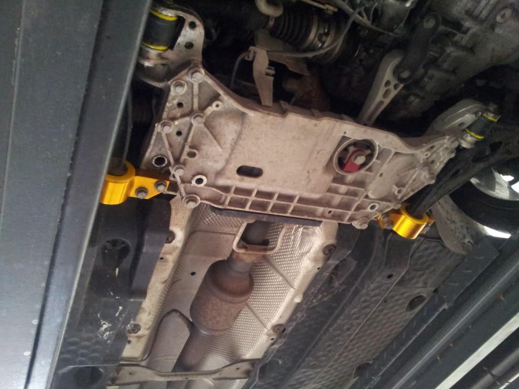

I had my WALK kit+whiteline bushes fitted a few day's ago and it's the best thing i've ever done,completley different car so much more refined and loving the extra power to the front wheel's with no wheel hop at all,engine mount insert  fitted as well! :happy2:
Great, thanks for that pic Sanj.  :happy2:
