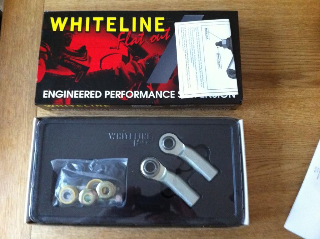

my latest addition. will be fitted next dry day!

Great piece of kit !!
 :happy2: :happy2: :happy2:
Waiting for a set of these as well.
