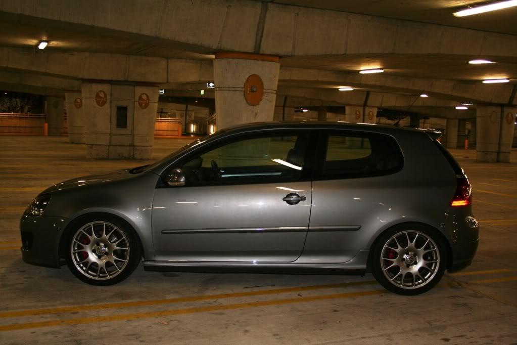

Offline ktlstar
  • Posts: 434
Re: Dan648v's ED30
« Reply #26 on: January 06, 2012, 01:37:45 pm »
Here you go -
Thats how it is at the moment!
- #1240 ED30 Revo STAGE2+
- Southeast - Vag Com owner
Offline Dan648v
  • -Given: 28
  • Posts: 795
Re: Dan648v's ED30
« Reply #27 on: January 06, 2012, 01:42:00 pm »
Looks well, Love the grey, was looking at that colour till my black one came up!
so Your all the way down at the back? How much on the front?
Offline ktlstar
  • Posts: 434
Re: Dan648v's ED30
« Reply #28 on: January 06, 2012, 01:49:44 pm »
Fronts at that time were halfway, but now all the way down. didnt change much as still i can clear 1or2 fingers through the arch/wheels.
Same with the back, all the way down no adjusters.
Yeah i picked her up for for a steal price at just 13k miles on the clock.
