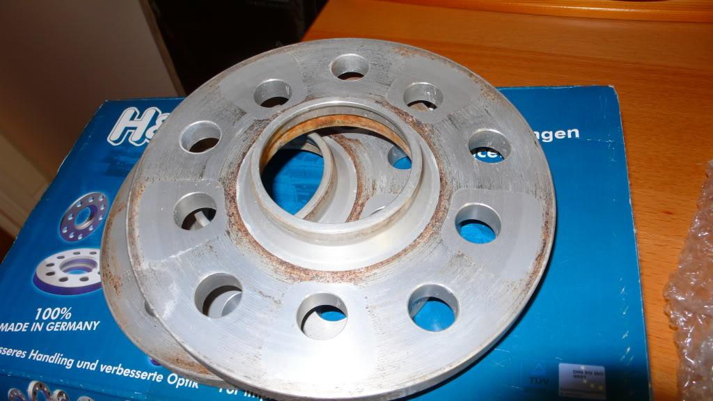

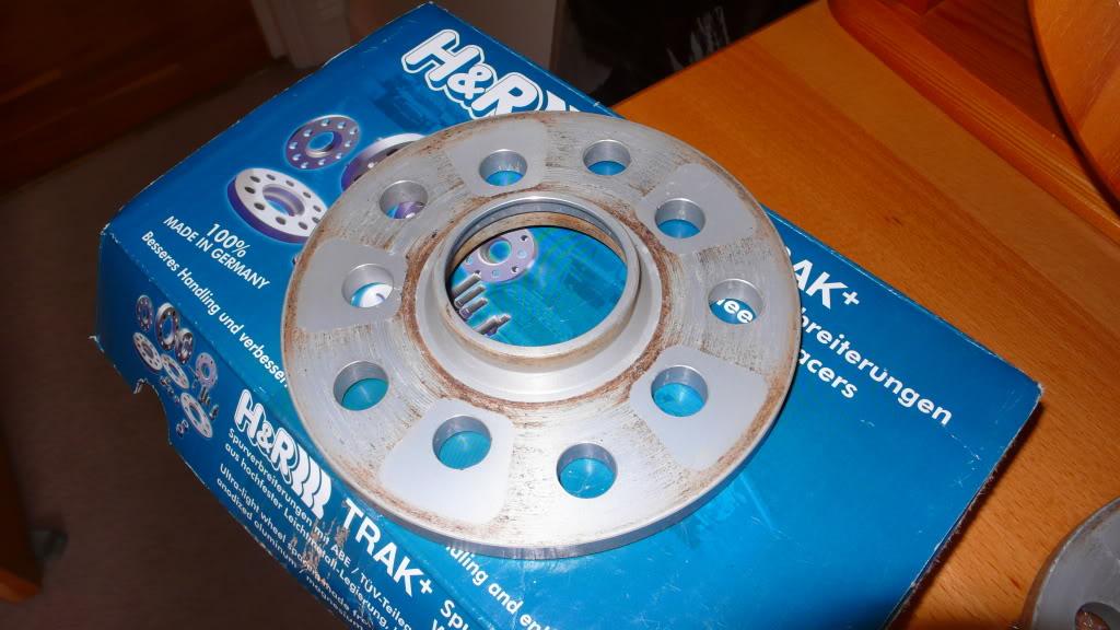

Here you go....
These were on my car for about 12k miles - no signs of damage or cracking

Of course it's expensive to regularly replace them and that's why motorsport is expensive because parts get regularly replaced before they fail.
The risk may indeed be small, but it's definitely a risk, otherwise this thread wouldn't exist.
It's up to the individual what risks they are happy to take.
Personally, I think the risk is what you buy. As always, you get what you pay for!
I've seen all sorts of spacers advertised and some look pretty cheap.
As mentioned, the H&Rs seem a sound engineered piece of kit adn have not caused me any problems.
