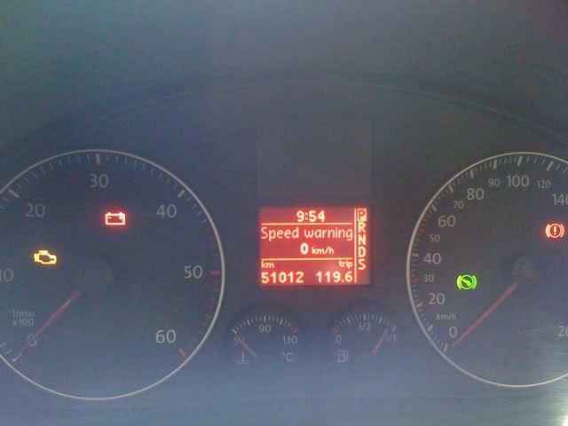

What is meant by highline and midline is the type of info screen between your rev counter and speedo.
Found this post by deako that's shows it easier
Midline:
Highline:
Depending on what you have and what functions you require, ie if you have highline do you want all the info displayed on there or not will decide what Bluetooth kit you need as VW loads and it depends on what yor after
