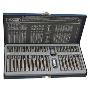

Something like this is ideal for regular work on VW's -
http://www.amazon.co.uk/Draper-Expert-21932-40-Piece-Tx-Star/dp/B0001K9R6W
Stu...
Re: What socket do I need to remove the rear brake carrier?
« Reply #6 on: May 17, 2011, 11:48:56 pm »
That set is very good VFM. I bought a set with about 10 bits for 15 quid
But that set doesn't have the M14 bit in it needed for the rear caliper!  :P
