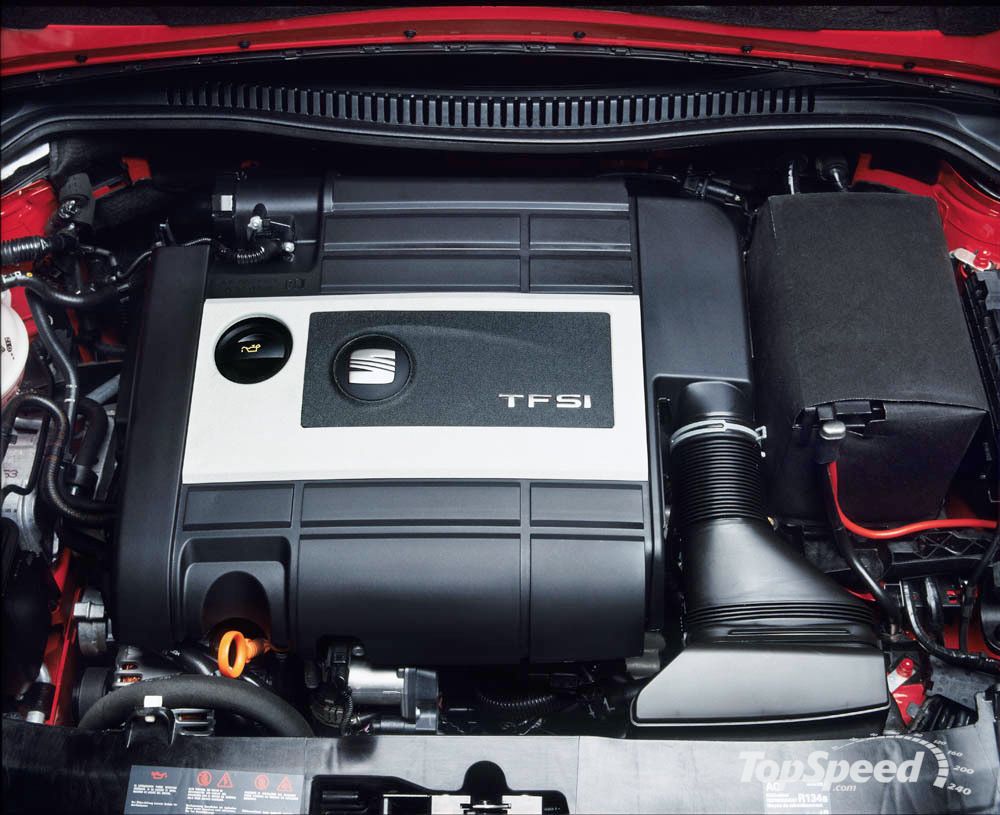

Here is a pic of the intake on the earlier engine:
and the later engine TSI or FSI:
The intake on the later engine looks similar to most of the aftermarket intakes available on the earlier engine.
