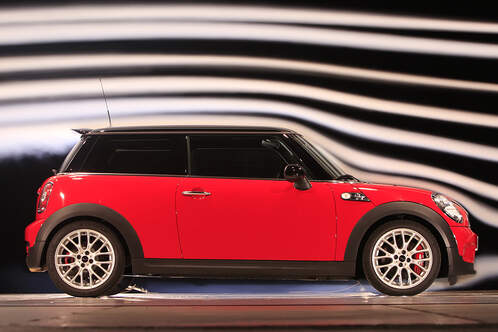

Mini Cooper S John Cooper Works
(A) 2.05 m²
(cd) 0.36
(cd × A) 0.73
at 200km/h
lift front 17kg
lift rear 20kg

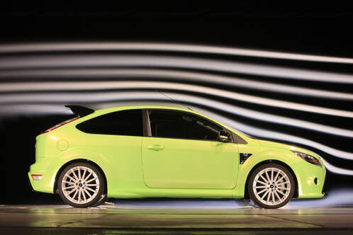

Ford Focus RS
(A) 2,35 m²
(cd) 0,36
(cd × A) 0,86
at 200km/h
downforce front 8kg
lift rear 4kg

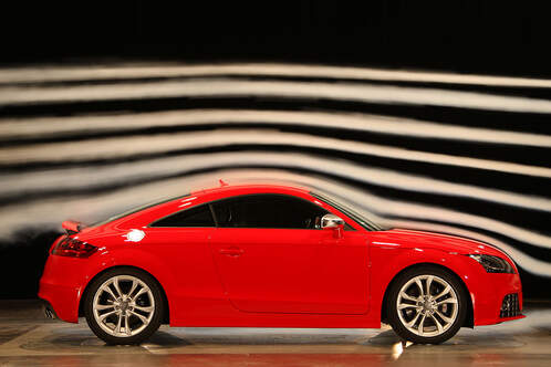

Audi TT-S
(A) 2.10 m²
(cd) 0.32
(cd × A) 0.68
at 200km/h
lift front 42kg
lift rear 17kg

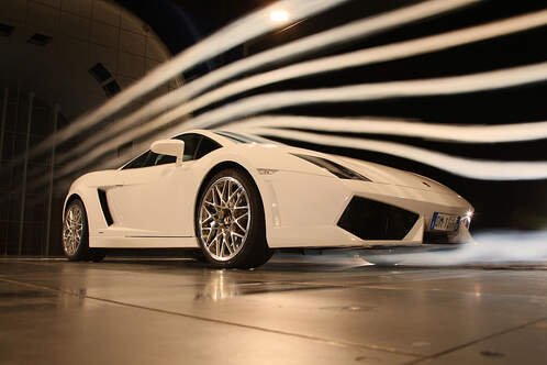

Lamborghini Gallardo LP 560-4
(A) 1.93 m²
(cd) 0.35
(cd × A) 0.67
at 200km/h
downforce front 4kg
lift rear 37kg

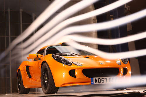

Lotus Exige S
(A): 1.62 m²
(cd): 0.44
(cd × A): 0.71
at 200km/h
downforce front 5kg
downforce rear 24kg

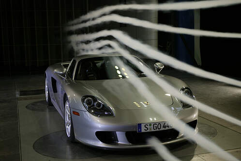

Porsche Carrera GT
(A): 1.95 m²
(cd): 0.37
(cd × A): 0.72
at 200km/h
downforce front 49kg
downforce rear 40g
