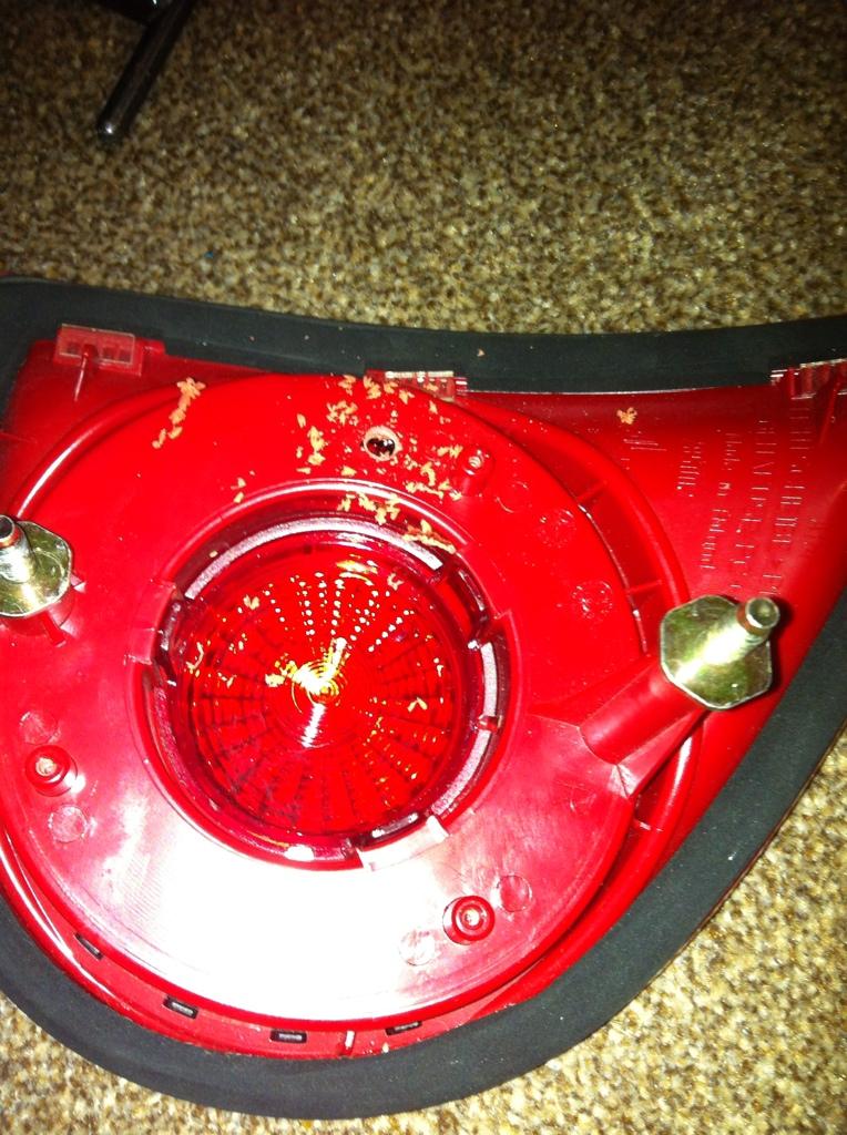

right so ive managed to find some time tonight to start uploading pics so to start
so to start i had 2 LED bulbs and soldered a length of wire on to each terminal
 then i took the fog light holder off the back of the light so i could see the back of the ring and marked where i wanted the bulbs
then i drilled the hole to the size i wanted, LEDs dont get hot so the i made sure the hole was spot on so the bulb is tightish in the lamp
next up was to mod the fog holder you can see the 2 parts ive cut out to clear the bulbs
after refitting the fog bulb holder i then cut the wires to form a loom
due to it being so cold outside i decided to use the boys scalextrix powere pack (its 13.5 volts  :happy2:) to power it up its been on for over an hour and the bulbs are stone cold :innocent:
now i cant get a good pic of them lit up here is about the best i can muster
if i wanna be mega picky at the top and bottom its alittle dull, i did think about a dob of black paint on the tip of each LED or even adding another 2 LEDs one top and one bottom to even the light out a little
so what do you think???

Looks good, really professional. Hard to see what the finished light will look lit, the flash on the camera probably does it no favours. Are you going to take a picture with them fitted, it would be good to see the comparison with the other light.  Keep up the good work you've really achieved something that is better than oem. :happy2:

Ive compared the light out put from these and the standard outers and i think they are very similar, im gonna fit them tomorrow (if its a little warmer lol) and then take a pic of them next to the filament outers, will use mrs millers flash camera without the flash, like i said there are a dull spot top and bottom but tbh its not much more than the dull spots on the outers
Thank you for your comments mate :happy2:
will get some more pics up tomorrow

personally at £30 id pay that little extra for 4 led's, if the wiring isn't that much more complicated for you, i think that a strong red ring will look more OEM.
Am i right in thinking these will come on as side lights? Have you tested the brightness vs the brake light + Fog?

I was thinking about 4 leds, top, bottom, left and right, the wiring would be easy, be a case of 2 looms and then joined to one, i havent tried the brightness with the fog on yet, but will do tonight, the main problem is LEDs send out a bright beam from the top, rather than all around, i wanna make sure they glow rather than look like bulbs in there, if you get my meaning, its about -4 here atm so i will wait abit before going out side  :signLOL:
