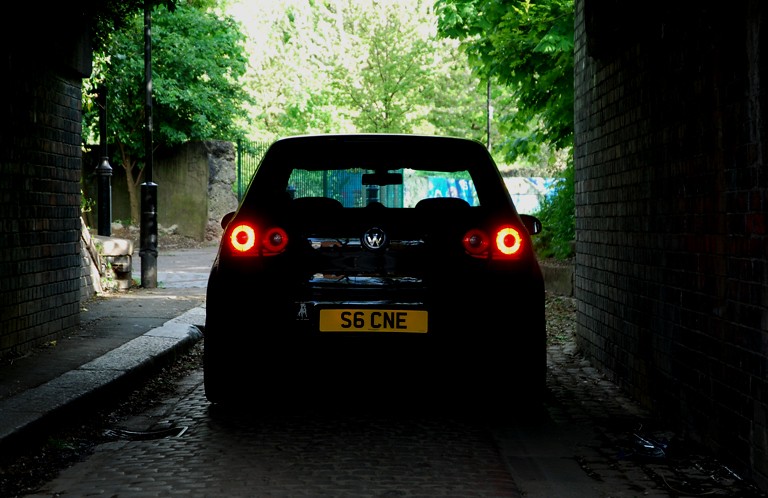

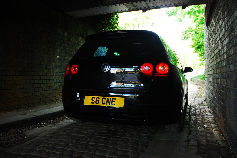

Quote from: Stanton
so, wired the centre rings to the aux backup light in the hatch, enabled them as rear parking lights and set intensity to match. et voila! you'd never know, looks OEM and no wires running anywhere other than inside the tailgate
also did some wiring on the cluster boards themselves to make the normal half circle brake lights, full circle.

Re: Re: Inner tail light mod units
« Reply #182 on: August 08, 2013, 10:33:26 am »
Do you get error on dash with the full ring brake lights?  I read somewhere only on early golfs it doesnt come up.
Sent From My Samsung S3
Im going to have a go at this when i get chance so il report back
