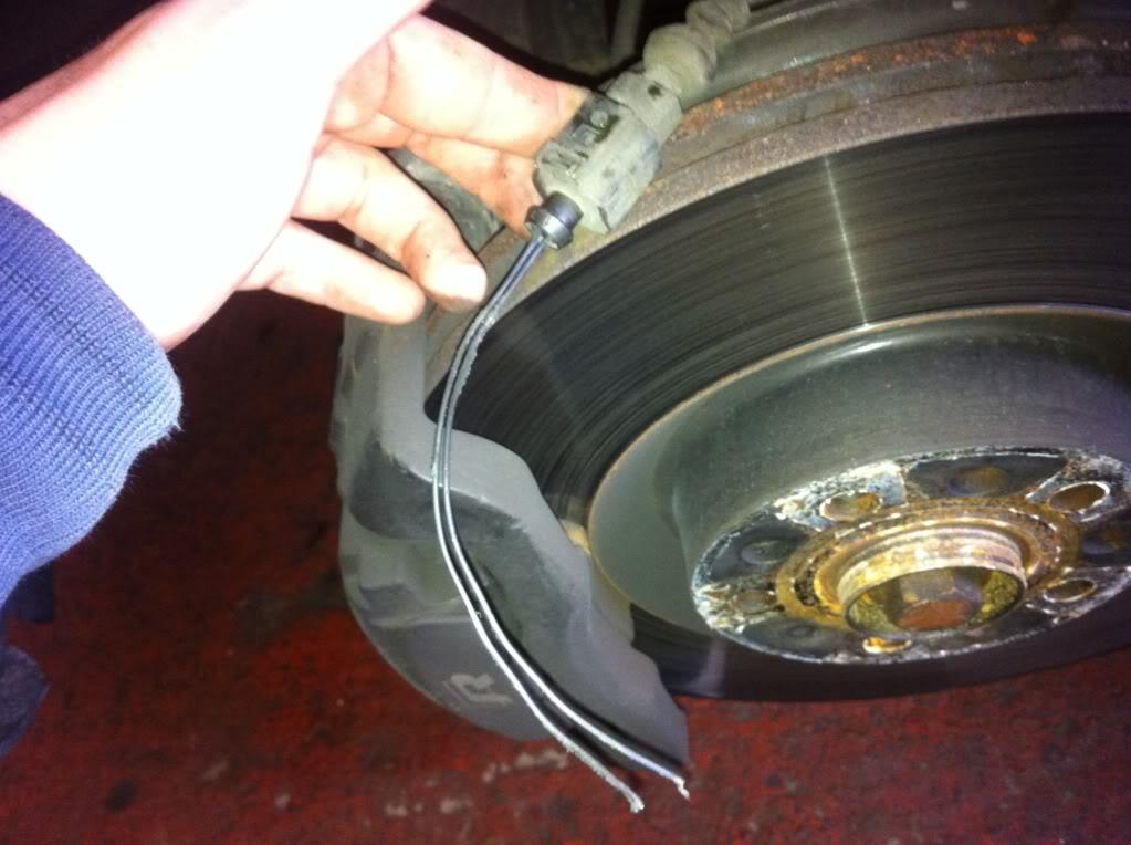

« Reply #9 on: February 20, 2012, 11:04:01 am »
no i dont
had the wheel off on friday and found my problem
pretty sure that should be attached to the brake pad
will it have to be a new brake pad or is it repairable??

« Reply #10 on: February 20, 2012, 01:26:30 pm »
If there is enough wire from the brake pad then you will be able to rejoin them up again.

« Reply #11 on: February 20, 2012, 02:38:36 pm »
or just join the two ends of wire together, and keep an eye on the brake pads for now until they do go down then when they do get low or near to low you can change them up for pads with an intact connector...
