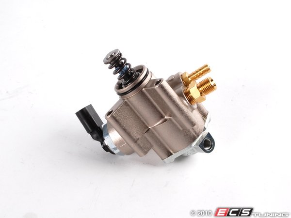

I've got a 2005 mk5 gti and when I went to buy a cam follower from the stealers they advised me to get a £9.50 rubber seal marked number 2 in the diagram ''they recommended me to get it'' so I did..
but when removing the HPFP I did not see a seal.. the only seal I seen was the rubber seal on the HPFP.. does anyone have any knowledge on this?? thanks...

That seal is on the fuel pump, perhaps not clearly shown on the diagram.

You can see it here -
Stu...

reuse your old seal, the find the ETKA number for the blue O-ring on your reciept then someone here can find out where it fits.
Unless you damage the O-ring on the HPFP there no need for a replavement O-ring when replacing the Cam follower  :happy2:
