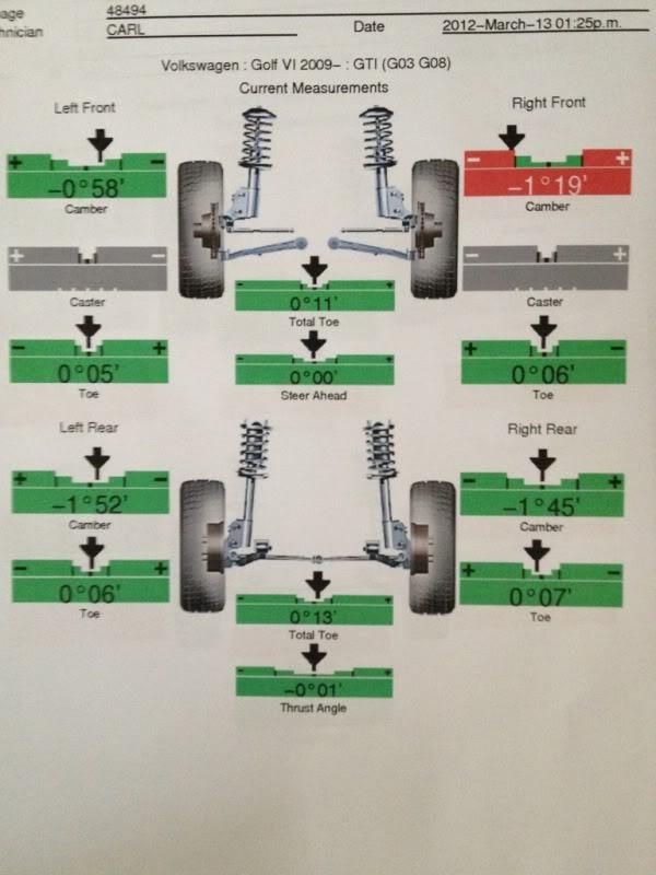

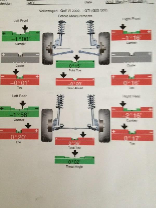

Sorry to hijack the thread, but I had a WALk kit fitted so had a 4 wheel alignment done today.
I noticed that there was a difference bewteen the front cambers, but the bloke said he was unable to adjust them :confused: otherwise is it ok?

Did they try to adjust camber on front?
If they did they had to loosen the subframe. Guess didn't take the time.
Toe is fine.

« Reply #17 on: March 13, 2012, 01:45:59 pm »
No they said they couldnt do it point blank.
It was different on teh before measurements, when I questioned him how it had changed, the reply was it was windy, and a strong gust of wind might have moved the sensor :laugh:

« Reply #18 on: March 13, 2012, 04:19:55 pm »
It is slightly adjustable through subframe but not massively. I couldn't get my guy to adjust mine he said the small amounts it's out it wasn't worth it he went through all the adjustments with me. How he explained every thing made sense to me. Although yours seems to have a bigger difference to mine

Re: Geometry are my settings ok?
« Reply #19 on: March 13, 2012, 04:23:30 pm »
Also one adjustment effects another also. As each time mine was adjusted he slightly adjusted another bolt.

« Reply #20 on: March 13, 2012, 06:43:46 pm »
why is there no caster measurement on your alignment?

« Reply #21 on: March 13, 2012, 11:12:34 pm »
The computer doesn't do caster on it's own. You have to move the steering wheel.  :grin:

« Reply #22 on: March 14, 2012, 01:02:26 am »
heavyd mine is the same as yours, im going back on thursday to get them to have a look but my readings are about the same as yours
