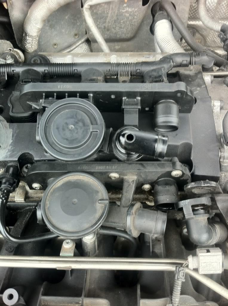

Hi, have just fitted a new pcv valve as my old one was broken, i fitted part no 06f 129 101 p which vw said was the newest one
picture shows old one on car and new one above it
fitted it and started car and its hunting and revving all over the place, is it now i have fixed this it has hi9ghlighted another fault if so what or is it the wrong part or ?
any help would be much appreciated
thanks craig

The newer pcv's have an additional check valve in one of the pipes if your car is older you need to change the pipe as well or stick to a certain revision before the check valve was added.

I had this when i replaced a PCV for a later version.
I took it off and got the same part no. as the one fitted and that cured the problem.

I think i remember reading anything past revision "N" will need the new check valve  :happy2:

I replaced mine with the N version - Part no. 06F 129 101 N a couple of weeks ago and all has been fine, certainly not had any rough idling.  Guess you'll need the new check valve as Fab5freddy says.  :happy2:

If your car is an early one it will need the N revision valve. If your car is circa 2007 then it will need the P revision valve. If your is the later one id say your rear check valve is broken and needs replacing. Or you could just fit the N revision and not bother with the rear breather hose.

Just seen your car reg in the members rides. You need the N revision as yours is a 2006 model.

Ok, thanks for the responses, will order a version N
Will put the version P on here for sale
