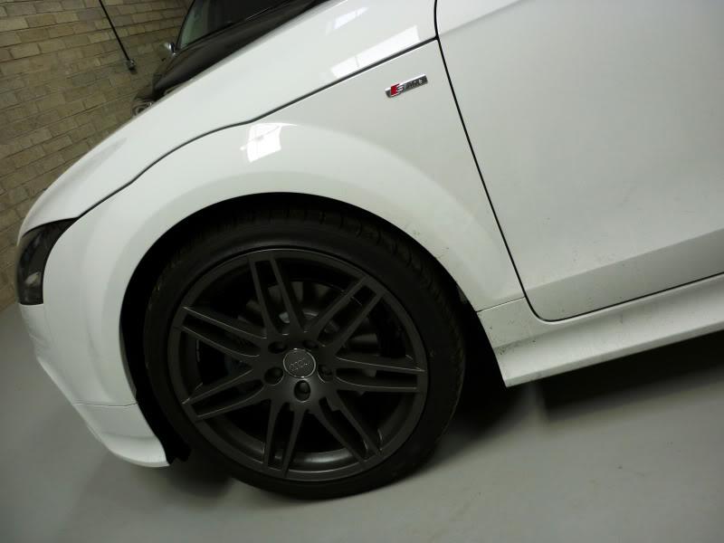

So, with just over 200 miles on the clock the car arrived looking something like this:

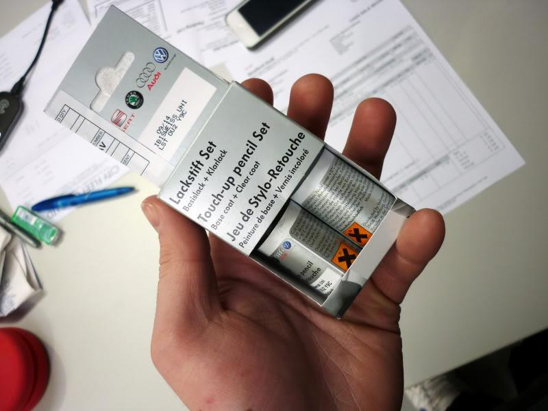

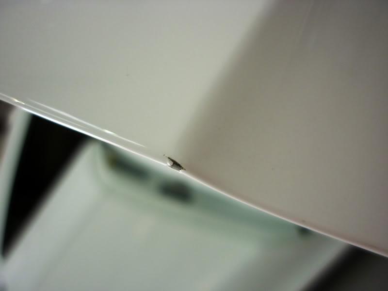

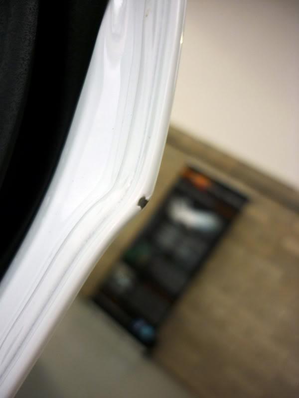

A chip on leading edge of the door, which was later touched in.
Special delivery!

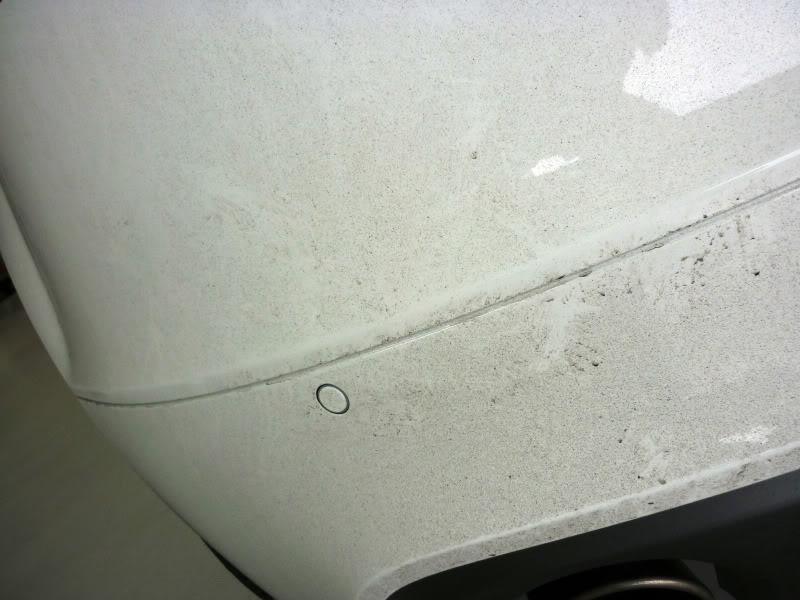

Some free residue from the dealer!

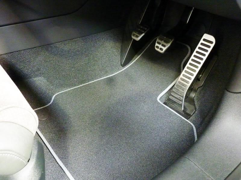

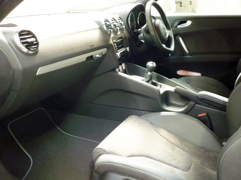

Interior was treated first. Despite Audi having carried out a full PDI there were various bits of paper, barcodes, stickers and dirt from production evident in the interior:
All surfaces were thoroughly hoovered, using various attachments:
Leather treated to Zaino Z9/Z10 twins.
Fabrics treated with G-techniq Smart Fabric.

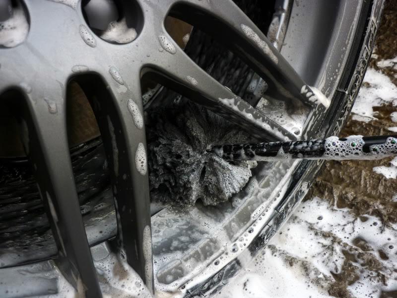

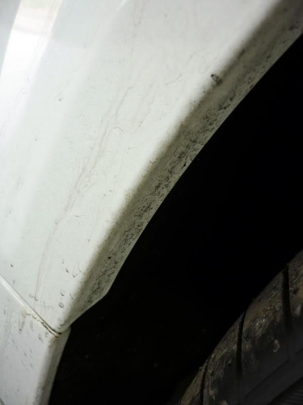

Tyres/arches cleaned with AS G101, Vikan Brushes.

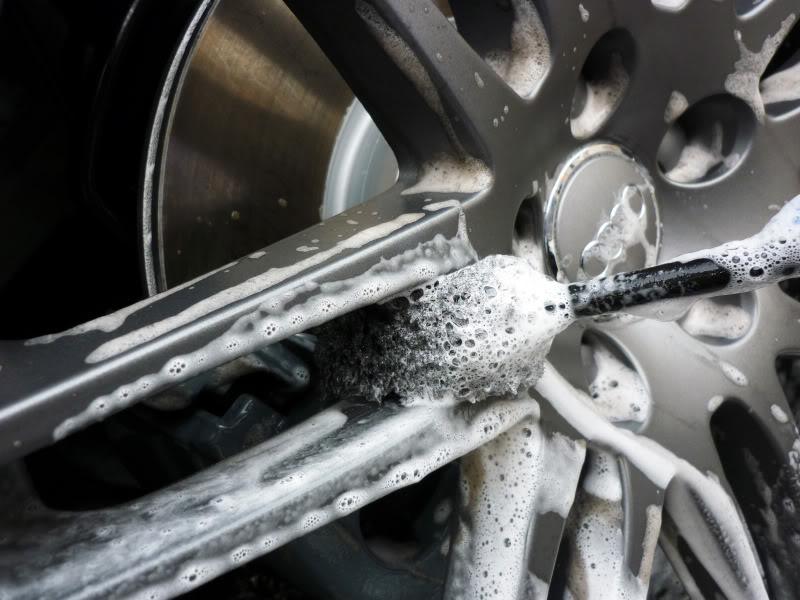

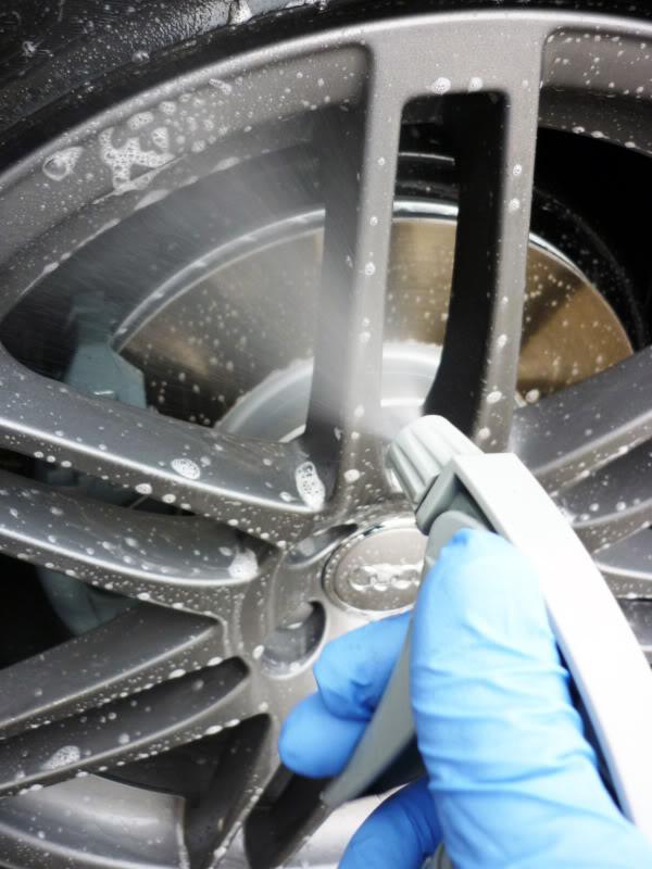

Wheels cleaned with AS Smart Wheels, Valet Pro/Lambswool brushes.

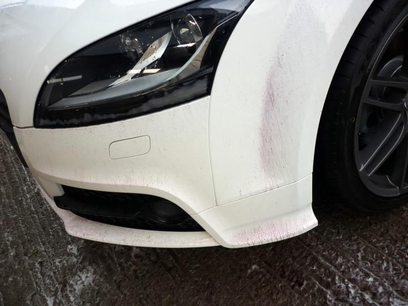

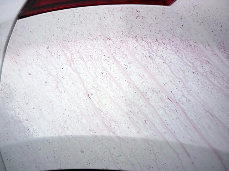

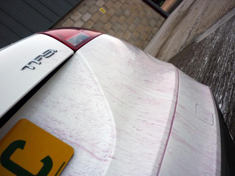

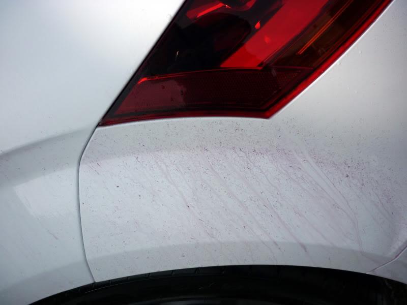

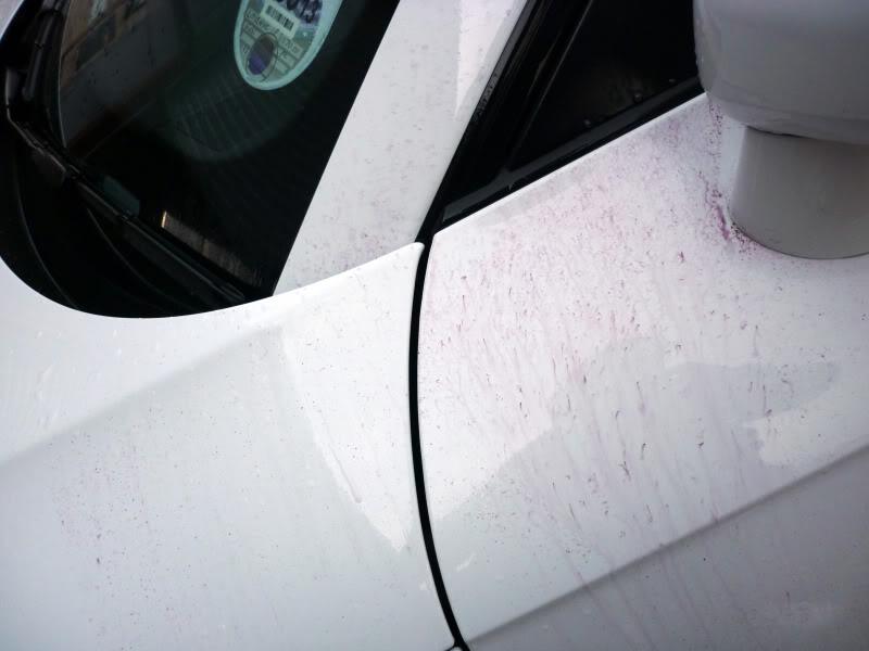

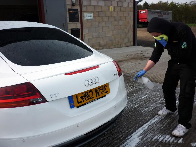

A LOT of Iron X was used, not wanting to be put off my lunch extra precautions were taken! :lol:
For a car thats covered just over 200 miles, pretty bad!
Car was then de-tarred with Tardis which revealed no tar contamination, re-foamed and thoroughly rinsed to remove all traces of decontamination products.

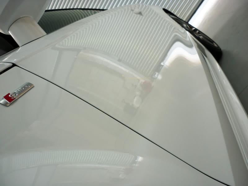

Paintwork lightly polished via DA, 3M Yellow Pad and Dodo Juice Lime Prime.

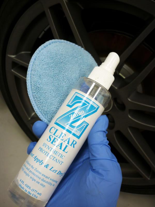

Wheels sealed using Zaino CS.

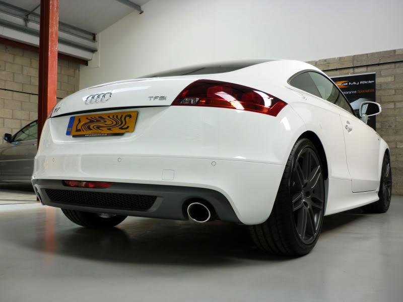

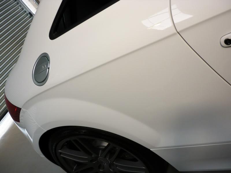

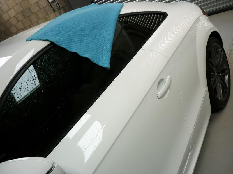

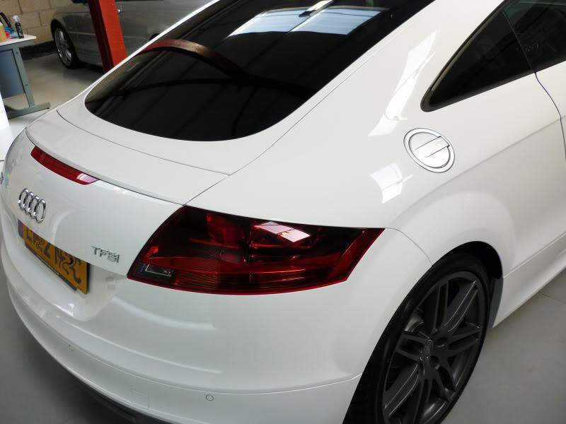

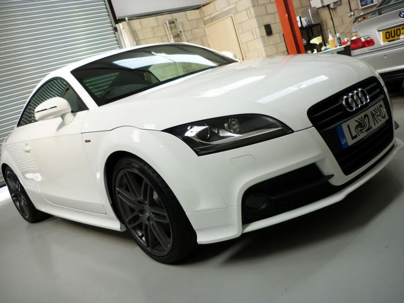

Paintwork wiped down with Zaino Z6, then treated with Z2/ZFX as sealant. This was mixed accordingly, then each layer applied and allowed to cure for around 30 minutes
Following Zaino application, finishing touches including Glass, Tyres, Exhausts etc were attended too, leaving the finished results!

Have you any pics after the paint touch up.  :happy2:

Good question, I'll check with my official photographer and get back to you!  :wink:

Chip was filled with paint, topped with a little lacquer and lightly flatted, unfortunately forgot to grab a finished pic!

Amazing how dirty a new car is.

Great car. Z-2 is awesome on white  :notworthy:
A lot of the fall out pulled out from the iron x is more than likely from rail travel. I'm sure that's how they are transported in most cases to the docks.
PM for details
Re: Zaino New Car Protection - Audi TT TFSI S-Line Black Edition
« Reply #10 on: April 19, 2012, 10:11:02 pm »
Indeed, although it looked pretty free from contaminates these things tend to either sit by railway lines or travel by rail without cover so always worth a quick spray with Iron X first!  :wink:
Always. When I done my dads 12 plate A3 with less than 40 miles on the clock it was the same. Nothing majorly visible, but the purple rain showed otherwise.  :laugh:
